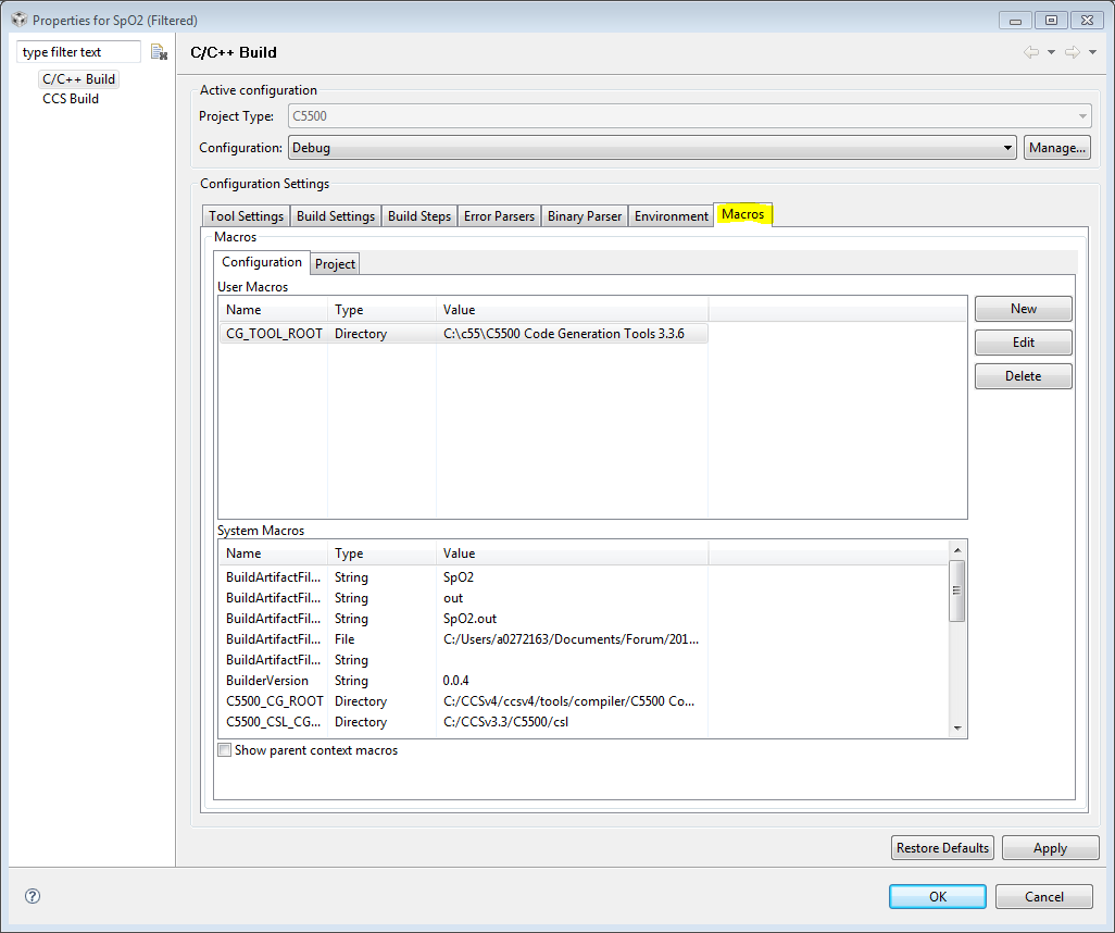

    The release notes say Codegen version 3.3.6 should be used... I got it to build with 4.3.9 but it may need 3.3.6
    You can download CGT 3.3.6 from https://www-a.ti.com/downloads/sds_support/CodeGenerationTools.htm
    Under Macros tab, you can create a new macro called "CG_TOOL_ROOT" and pass the path to CG_Tools after downloading
    This macro variable will override the System Macro...

  • Hi Mark, so I done all of the above except for setting up the macro.  Where can I find the "Macros tab"?  I still get all 5 errors when i try to build with my CGT 4.3.9  version.  Will using 3.3.6 version finally fix this?
    James
  • Mark, I have it building under the 3.3.6 CGT.  I have performed all of the steps above.  I had visited the Wiki before I reached out to the community.  I still get the following 5 errors:

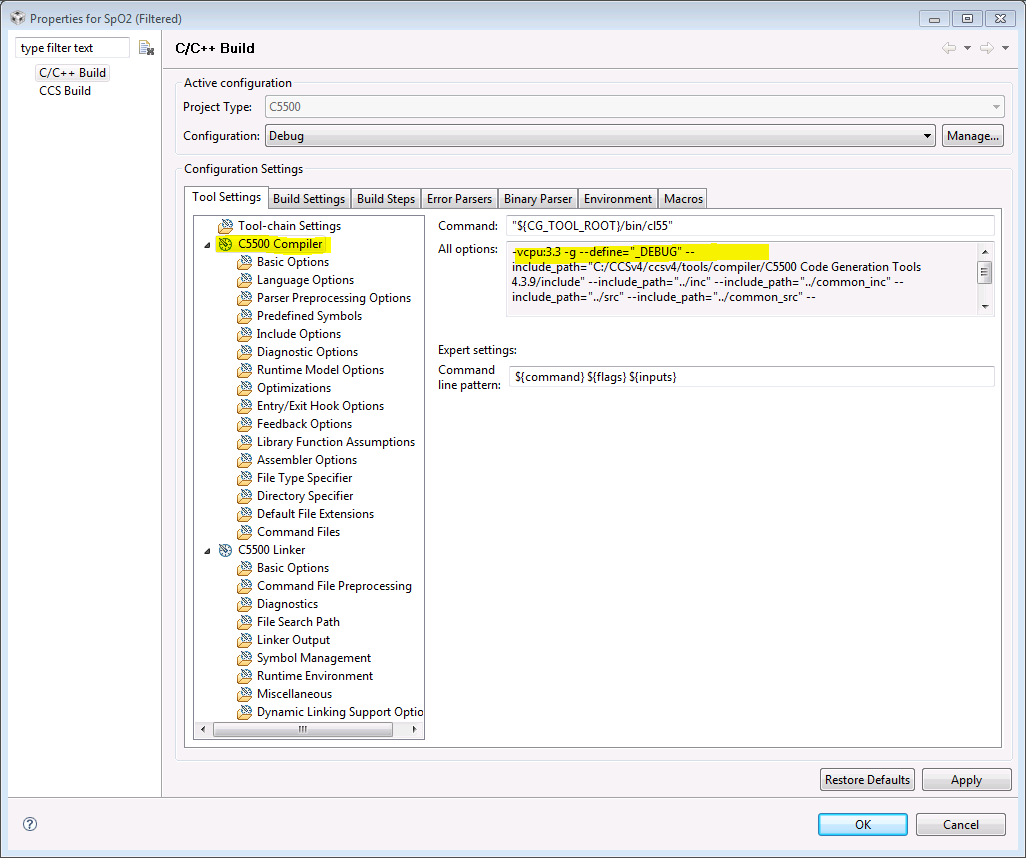

  • Hi James,
    I dont think CGT 3.3.6 will resolve those errors because I am able to build with CGT 4.3.9 and 3.3.6 without erros - it must be an include path missing or in bad order. If you cannot get the errors resolved, copy and paste the console for one of the files thowing errors like I have done below for I2C_SpO2.c...
    "C:/CCSv4/ccsv4/tools/compiler/C5500 Code Generation Tools 4.3.9/bin/cl55" -vcpu:3.3 -g --define="_DEBUG" --include_path="C:/CCSv4/ccsv4/tools/compiler/C5500 Code Generation Tools 4.3.9/include" --include_path="../inc" --include_path="../common_inc" --include_path="../src" --include_path="../common_src" --include_path="C:/CCSv4/bios_5_41_10_36/packages/ti/bios/include" --diag_warning=225 --large_memory_model --algebraic --preproc_with_compile --preproc_dependency="src/I2C_SpO2.pp" "../src/I2C_SpO2.c"
    I have also put screen shots of my Build Properties and the Macros tab for your reference.

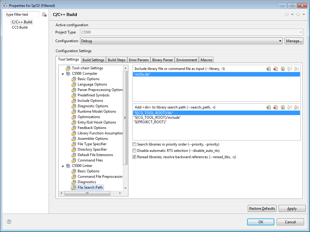

  • Hi James,
    rts55x.lib is in the CGT lib directory.
    In the Linker File Search Path - ${CG_TOOL_ROOT}/lib
    CG_TOOL_ROOT is defined under the Macros tab.
    Hope this helps,
    Mark

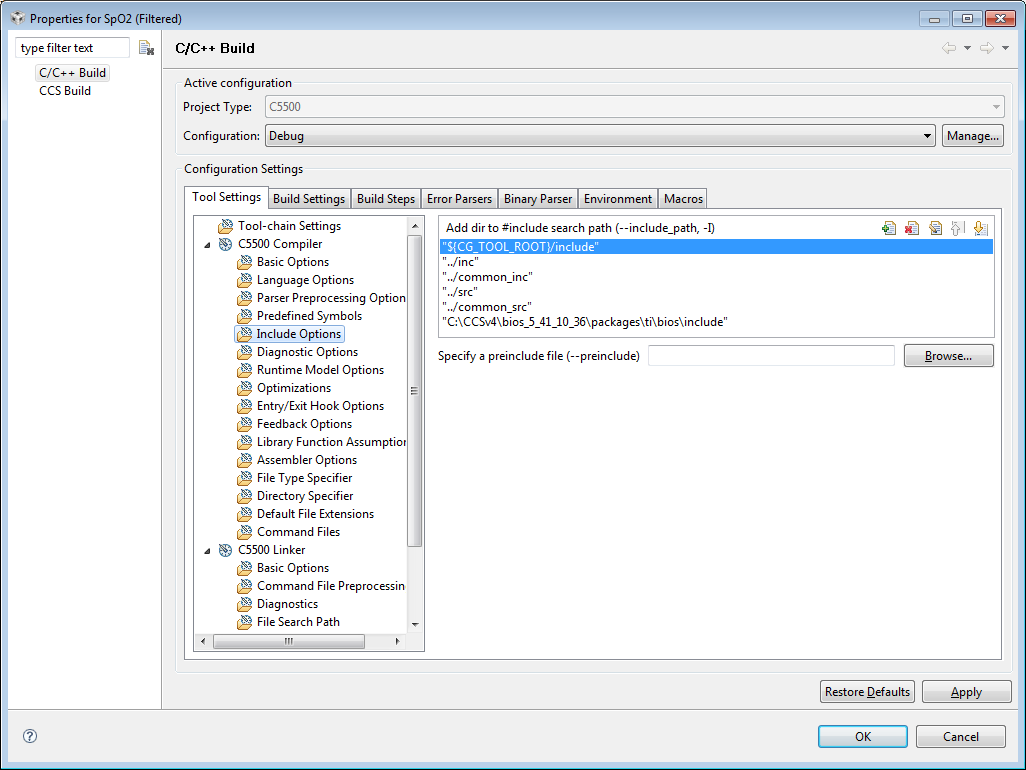

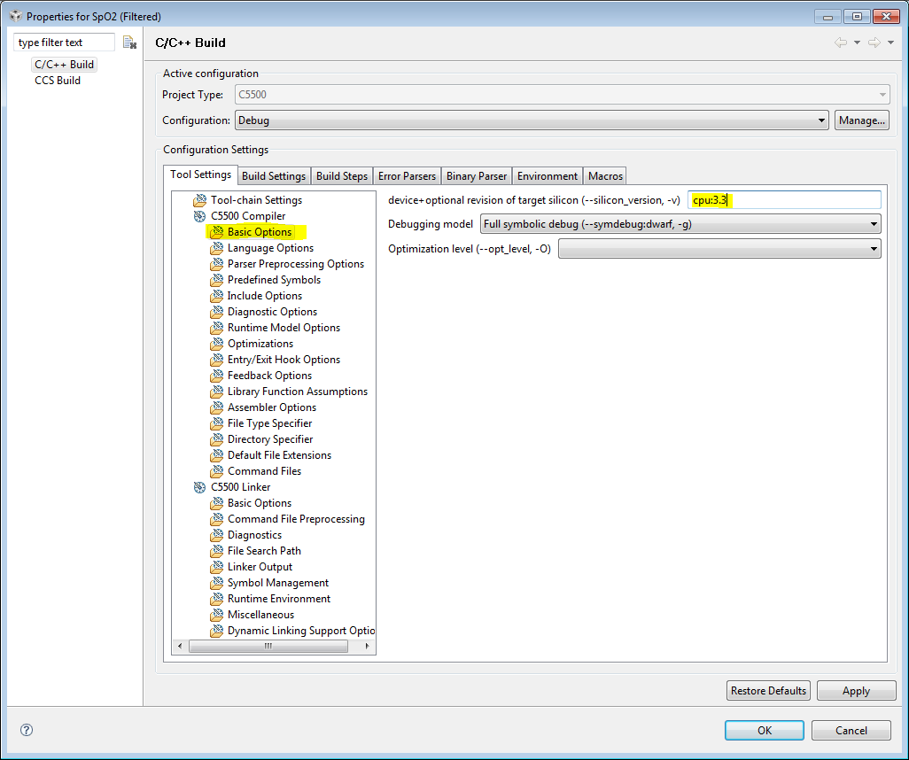

  • You are not correctly including BIOS include dir in the compiler search path - this is the reason for the fatal error: could not open source file "hwi.h", etc
    You should have deleted the XDAIS dir path from the compiler search path - it is not used here and included when importing
    You're also not specifying silicon version in the build properties (-v cpu:3.3) - it is needed by tools and should have been imported from CCS3.3 project by CCS 4.x... See the screenshot at the bottom of this post.
    James McPherson said:
    "C:/Program Files (x86)/Texas Instruments/ccsv4/tools/compiler/C5500 Code Generation Tools 4.3.9/bin/cl55" -g --define="_DEBUG" --include_path="C:/Program Files (x86)/Texas Instruments/ccsv4/tools/compiler/C5500 Code Generation Tools 4.3.9/include" --include_path="C:/Program Files (x86)/Texas Instruments/xdais_6_25_01_08/packages/ti/xdais" --include_path="/include" --include_path="../inc" --include_path="../common_inc" --include_path="../src" --include_path="../common_src" --diag_warning=225 --large_memory_model --algebraic --preproc_with_compile --preproc_dependency="src/pal_osWait.pp"  "../src/pal_osWait.c"
    Your compiler console output broken down by each argument...
    -g
    --define="_DEBUG"
    --include_path="C:/Program Files (x86)/Texas Instruments/xdais_6_25_01_08/packages/ti/xdais" - Delete the XDAIS path from the Build Properties --> Compiler
    --include_path="/include" - macro for BIOS did not work? This path is invalid as is. Try replacing with the full file path to the BIOS include dir (Mine is C:/CCSv4/bios_5_41_10_36/packages/ti/bios/include)
    --diag_warning=225
    --algebraic
    Compare with my console break down that works:
    -vcpu:3.3
    -g
    --define="_DEBUG"
    --diag_warning=225
    --algebraic
    Screen shot showing where to configure silicon version:
    Hope this helps,
    Mark
  • OK Mark I have implemented everything you pointed out.  I actually deleted the project and Imported it so I could start from scratch.  I still get the same errors.  Here are the steps I took:
    1. Added "cpu:3.3" under basic options.  It looks the same as you screen shot above
    2. Deleted "${XDAIS_CG_ROOT}/packages/ti/xdais" from the include options
    3. Deleted "${C5500_CSL_CG_ROOT}/lib" from include options
    4. Moved "${CG_TOOL_ROOT}/include" to the top of the list in include options
    5. Added the bios include path and moved it to the bottom of the list.  My installed path is: C:\Program Files (x86)\Texas Instruments\bios_5_41_02_14\packages\ti\bios\include      I can see that the file tistdtypes.h is there in the directory.
    6. Fixed the Linker search path by deleteing "${C5500_CSL_CG_ROOT}/include", and typed in the file name rts55x.lib in to the include library file portion.
    7. Made sure there was a macro CG_TOOL_ROOT that points to C:\Program Files (x86)\Texas Instruments\ccsv4\tools\compiler\C5500 Code Generation Tools 4.3.9
    8. Commented out std.h everywhere it gave me an error.
    9. Added tistdtypes.h in this like this in the same places:  #include "tistdtypes.h"
    After all this I still get the same 5 errors.  I hope this helps you figure out what I am doing wrong.  I have attached a word doc with screen shots of how I have set everything up.  Thank you.

  • James,
    I hate to sound like a broken record, but the console still shows the broken BIOS path and still includes XDAIS path...
    -vcpu:3.3
    -g
    --define="_DEBUG"
    --diag_warning=225
    --algebraic
    --preproc_dependency="src/pal_osSem.pp"
    "../src/pal_osSem.c"
    The screen shots in the .doc file and the console output do not match... You can see what the console should look like if you click on 'C5500 Compiler' in the build ..
    Hope this helps,
    Mark
