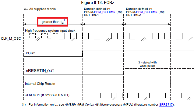

I would like to clarify about the PORz time after boot-up.
I have refered the AM335x TRM Figure 8-18(spruh73g: P533).
There is the description that PORz have to be greater than tsx.
But, I know that the tsx is requirement of Crystal circuit.
Since the crystal circuit have been already stable after boot-up, I think it is not requirement of PORz after boot-up.
I need the MIN time of PORz after boot-up.
May I have the following answer:
 - Where is the requirement of PORz after boot-up?
 - The tsx is TYP value. After boot-up, can I think it is MIN time for PORz requirement? (Bacause the crystal circuit have been already stable.)
Best regards, RY
  • What do you mean by boot-up? Normally booting commences when the device has been released from reset, sysboot values have been latched at reset rising edge, and ROM code execution begins.
    If you mean power-up, then I don't see any misalignment in the documents. Reset should be released after the crystal oscillator has become stable. A typical value is given for tsx, because this can vary with crystals used in custom board.

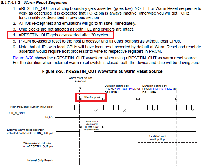

    Is the warm reset(nRESETIN_OUT) only supported after boot-up?
    Best regards, RY
  • I can say that manually resetting the board from PORz isn't normally practiced. This signal is usually driven by the PMIC and you should check if the PMIC (or other reset supervisor) output  that drives PORz is open-drain. Otherwise you could damage the output driver.
    The preferred way for manual reset is asserting nRESET_IN_OUT, as shown in the AM335X TRM, Figure 8-19.

    May I have once more question about nRESET_IN_OUT time?
    How long cycles do we have to hold to low on nRESETIN_OUT pin?
    Is MIN value 30 cycle? or 50 cycle?
    Best regards, RY
  • Hi RY,
    The min. value is 30 cycles for the external warm reset. The 30-50 cycles timing on the diagram is concerning the time it takes the EMIF FIFO to be drained and DDR put in self-refresh, after which the internal chip reset is asserted. This time can't be specified precisely as it's dependent on the EMIF FIFO state at the moment.
