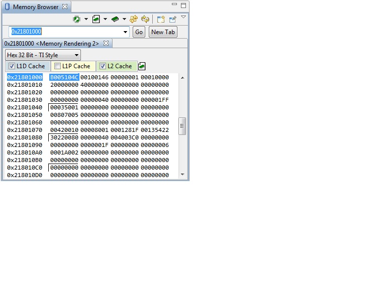

    3. The local register settings of PCIe interface after link up is attached. Please find it. This is for 5Gbps and x2 lane scenario. You also can see the other register settings that I use.

    3. The register seems to indicate it is x2 GEN2 mode.
