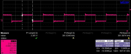

  • Rahul,
    I have the core running at 456MHz.
    To do a simple test, I just set a GPIO and clear it in the while:
    while (1)
    GPIO_setOutput(GPIO_BANK7, GPIO_PIN9, OUTPUT_HIGH);
    GPIO_setOutput(GPIO_BANK7, GPIO_PIN9, OUTPUT_LOW);
    It takes 1.6µs to set high and 1.6µs to clear it with an optimization level of 3.
    Could you try the same thing and tell me if it is normal or not?
    It seems that it takes a very long time to just set or clear a GPIO. And for 300MHz, I get 2.573µs. For 100MHz, 7.563µs.
