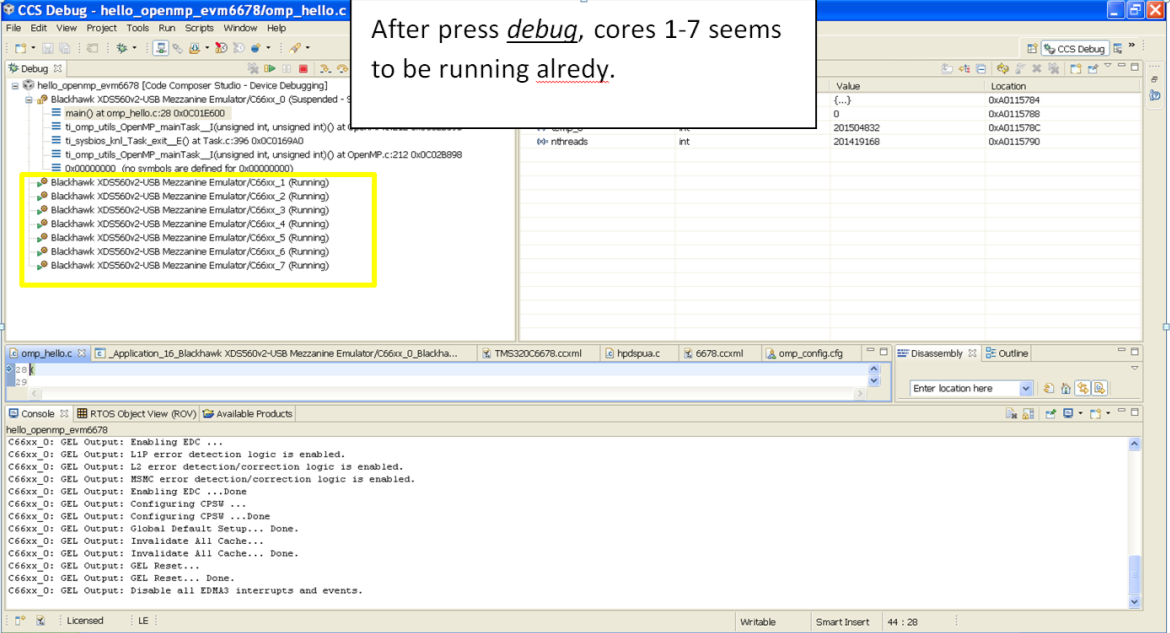

    actually I was trying a simple example [http://processors.wiki.ti.com/index.php/OpenMP_on_C6000], it just print "Hello World from thread = X" using just 4 cores
    but it give me a similar error as above when I try to run it.

  • Julian,
    This is a "known" issue with the compiler version 7.4.1 and 7.4.2.  You need to use 7.4.0.  I am trying to track down a download link for you now.
    Mike

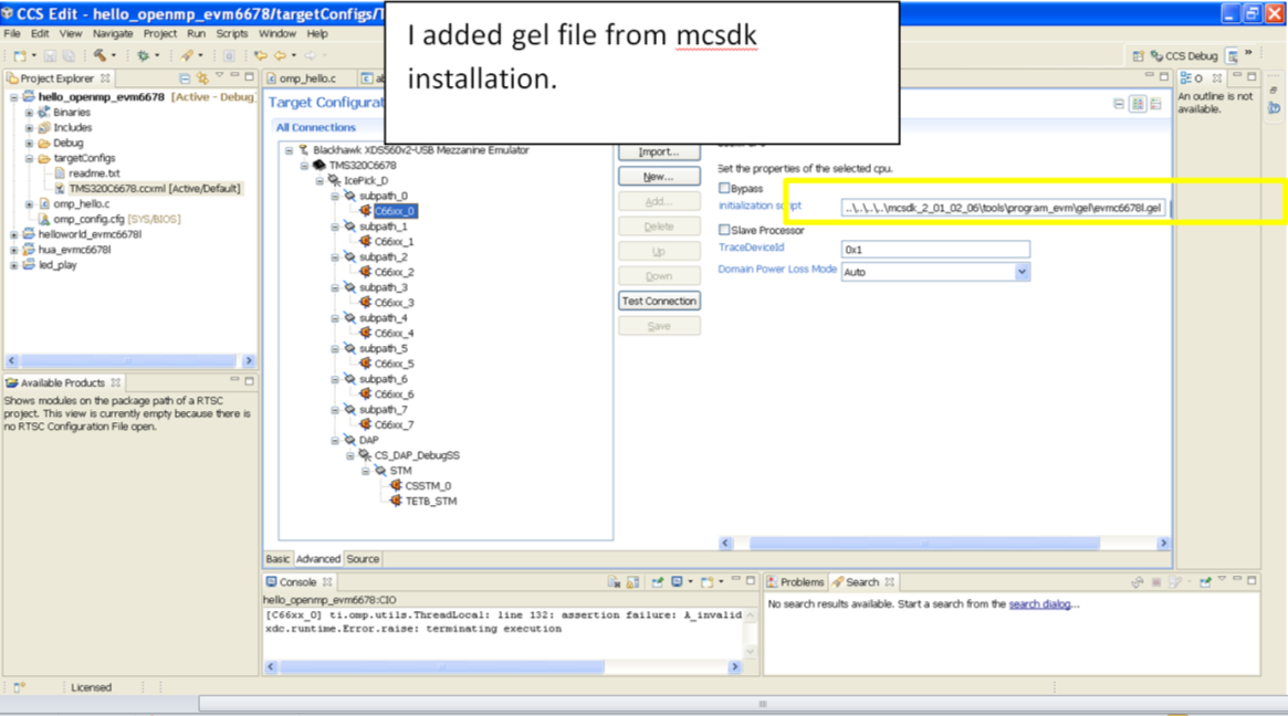

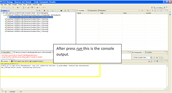

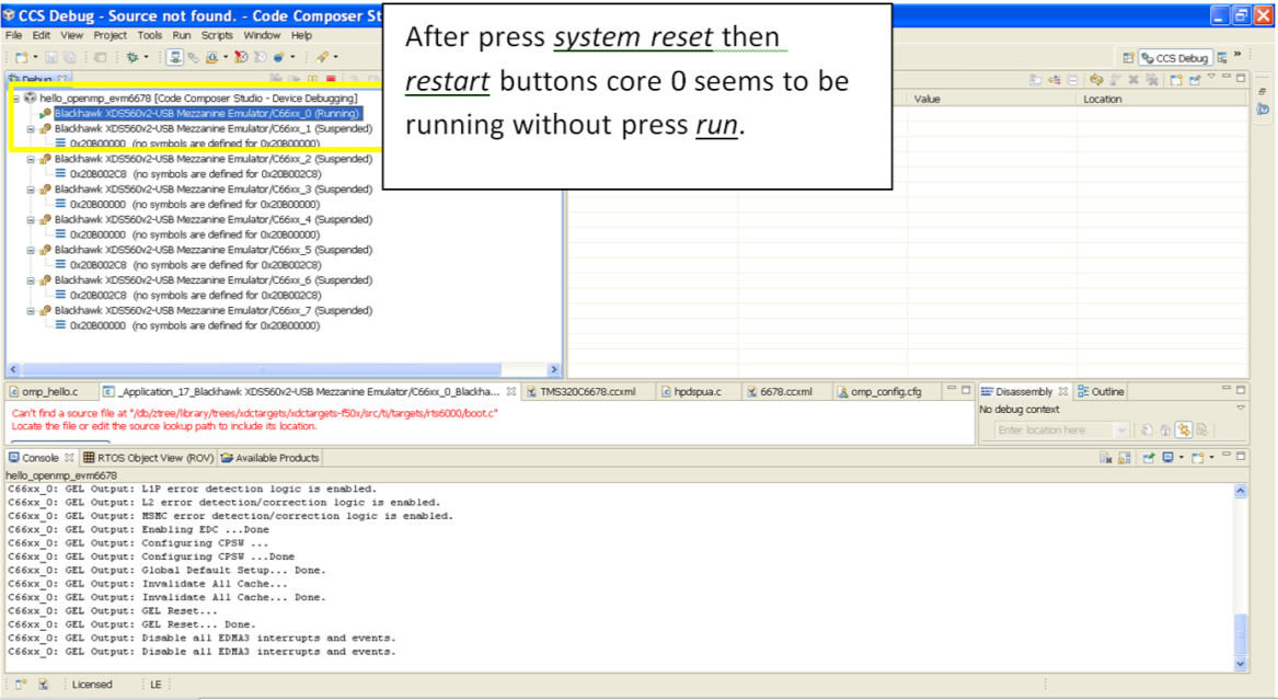

  • The wiki recommends creating a new CCS project, using the OMP Hello World template.  I did the same and got similar output to Julian's (much is the same, so I missed that our exact exceptions were differnt):
    Internal exception: IERR=0x10
    Resource conflict exception
    ti.sysbios.family.c64p.Exception: line 248: E_exceptionMin: pc = 0xbbc47a30, sp = 0x00828eb8.
    To see more exception detail, use ROV or set 'ti.sysbios.family.c64p.Exception.enablePrint = true;'
    xdc.runtime.Error.raise: terminating execution
    I installed CGT 7.4.0 and it works...  I dunno.

    I follow Michael recommendation and openMP example works.
    Now the hua_evmc6678l works well sometimes because when I click run i get the IP and
    I consult the browser and the demo is running (This has happened a few times). But the most of times

  • Mike,
    thanks for your answer,
    I was not using gel file, now I added
    the gel file what comes with mcsdk with path: mcsdk_2_01_02_06\tools\program_evm\gel\evmc6678l.gel
    The other thing is that I was using switches sw3-sw6: 0010/1011/1110/1111 sw9: 11.
    Nom I am using no boot configuration sw3-sw6: 0111/1111/1111/1111 sw9: 11
    The thinks improve with hua_evmc6678l it seems to be more stable when it runs and  get the IP using DHCP (sometimes it fails or hang out waiting for link up),
    but the problem remain strong  with the hello_openmp_evm6678
    I follow the next steps to try it runs correctly:
    I hope this images give more information about the problem.
    About the server, here in the company are using a enterprise server.
    The only to consider is that demo oob demo is running without problems using dhcp here at he office,
    I don´t know if the demo using emulator must have a different behavior.
    Thanks.
    Julian

  • Julian,
    Going through the example again with a critical eye tells me your project may need a few checks:
    1) Is the compiler set to 7.4.0
    2) Is there a GEL file specified?
    3) Has the cfg file been modified?
    4) Are you running on just the first 4 cores?
    I've attached a PDF of my notes made during the process.  Please go through them and let me know how it goes!

  • Mike,
    it seems that I was working with:
    1)  7.4.2
    2) mcsdk gel file
    3)  and 4) I had modified cfg to use 8 cores so the NTHREADS was changed to 8.
    I follow your indications and the example runs like you said in your pdf, but the point is that I can´t
    restart the demo, the only way is to exit from debug session and enter again.
    Does this happen to you?  If not please tell how you restart the demo without leaving debug session.
    Other thing is that I need to run 8 cores  so if you could tell me what to modify to do it properly I´ll appreciated.
    Julian

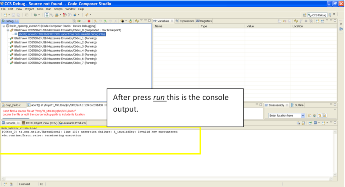

  • Mike,
    your instructions work with the demo using 4 cores,
    demo is not working when I try to change to 8 cores because
    when i enter to debug  session the cores 0 to 3 appear running and the rest of them as disconnected.
     and it is impossible to get it runs correctly.
    I have attached my ccxml and cfg files, I hope it helps to see
    what I am doing wrong.
    4034.cfg_ccxml.zip
    Julian

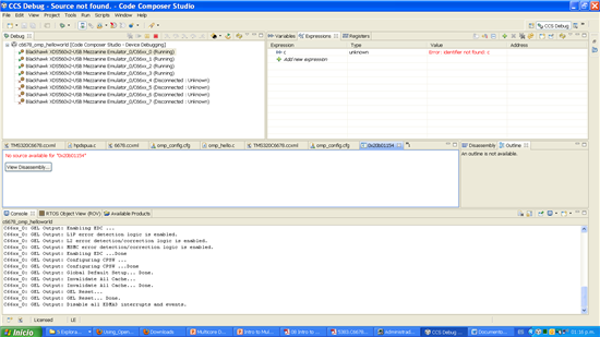

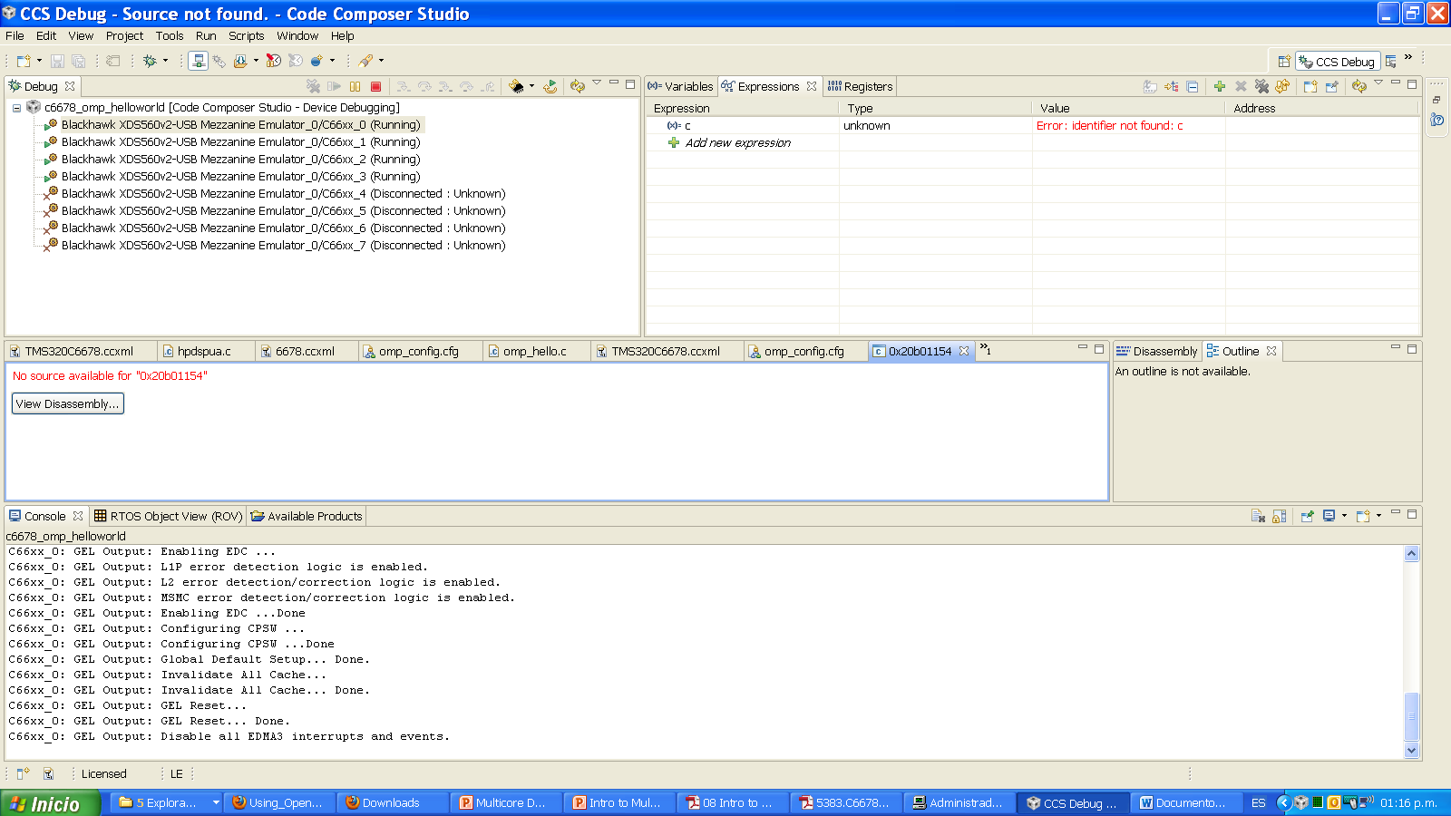

  • You must load the program on all cores you intend to run the program on- I forgot to mention that.
    Do a system reset.
    Select cores 4-7, right-click, and select Connect Target
    Select all cores (0-7), go to Run->Load->Load Program, select the proper ".out" file (it will likely already be selected for you).
    Press F8 to resume.
    To run it again, do a System Reset, Select all cores and press Restart, then select Core 0 and press Resume (twice).
    When you first hit debug, you are given a popup window to select which cores to load the program to.  I have not figured out how to bring that window back to allow you to select all 8 cores to streamline this process a bit.
    MIke

    I just create the project again and I change the .cfg an ccxml file to 8 cores then I press debug
    and the window that let me select cores appears, I checked 8 cores, and press ok.
    To run the demo I just press system reset then selected all cores  then load program then select core 0 and press run. This procedure
    has to be done every time I want to restart the demo.
    I was wondering  what is the difference with hua_evmc6678l demo because  I was searching in ccxml files and there  is not a definition of numbers of
    cores.
    I was thinking if both demos are using openMP, if not what is hua_evmc6678l using ?  I ask this because I am interested  in doing application that runs 8 cores with NETCP PA, PCIe and it seems that I need to use Multicore Navigator too for that, and hua_evmc6678l seems to be the most close what I want.
    Julian
