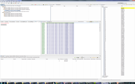

  • Chad: My code fails to load. It goes into weeds when I load the program and therefore continues to run without ever reaching the main symbol. On one such behavior, I paused execution and B3 reads 0xE1A7C0F0, which is a location in a memory-mapped L2 shared MCM that is made non-cacheable. However, I am not allocating any text to that section, only data. So why should B3 hold a data section address?
    I'm appending some content from my linker command file that may be relevant, but I'm not sure if it helps. Please let me know what else should I give you in adding to the out file.

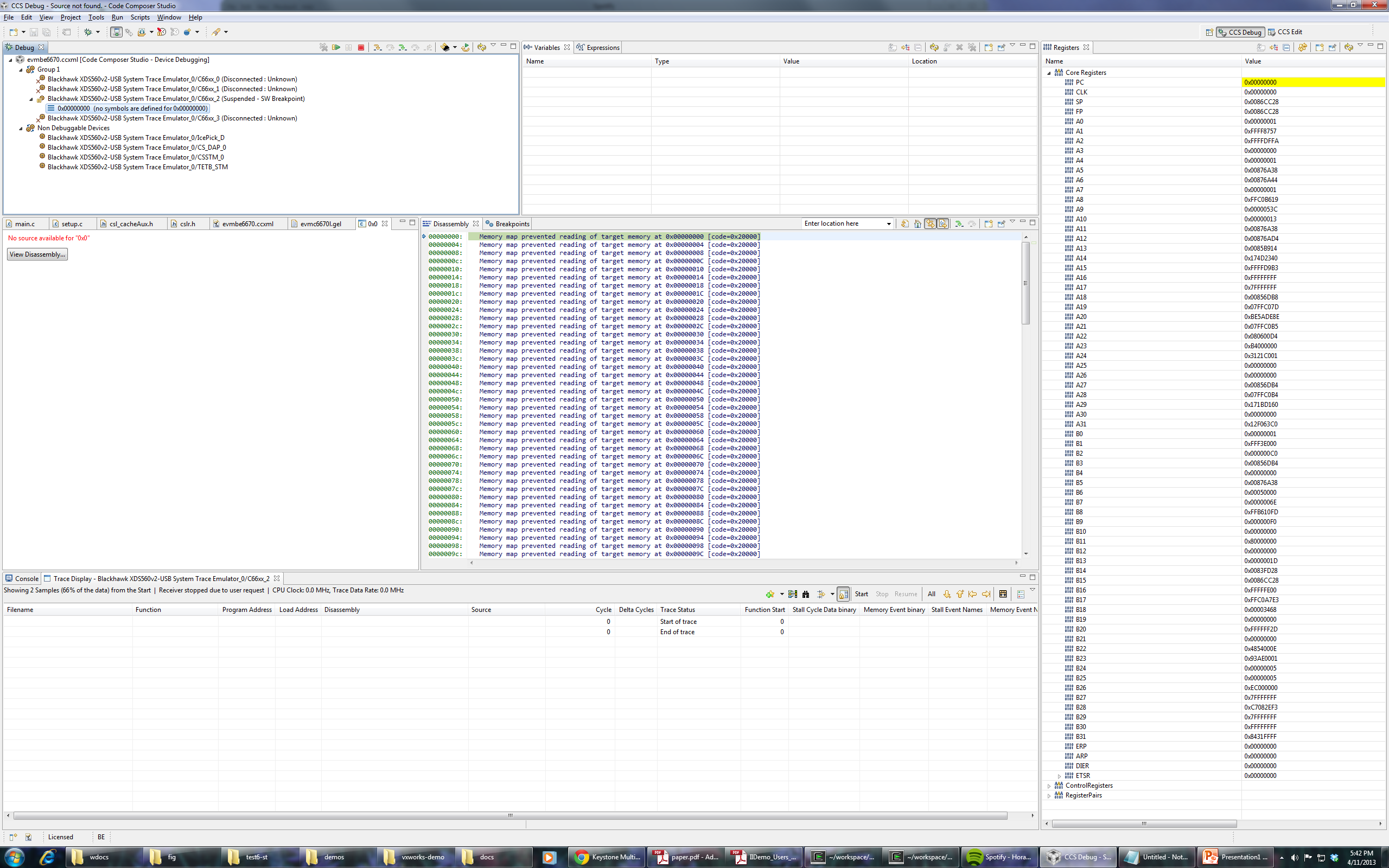

    I'm loading the code over JTAG via CCS. I think "load fails" is causing confusion. It is not failing in the strict sense of CCS reporting that load failed. Code does load, but then the initialization execution that automatically happens upon load in CCS is when the code goes into weeds. I think that phase corresponds to zero initialization and such things. What I call a successful load is when the program loads, runs up to main symbol and then the core waits in the debug-break state, ready to resume execution. In this particular scenario, it never reaches that debug-break state on the main symbol and shows as "running/resume mode" forever.
    This is an Advantech 6670LE EVM. You are right, there is no DDR at 0xE0000000. I am mapping the shared memory to that address range and setting the non-cacheable flag on it, both through software. This is so that I can use the shared memory as an L2 SRAM that stays coherent across cores since it is never cached in any L1. I am not using the DDR at all. This setup has been working fine for a long time. I don't think there is any issue there. I just mentioned it because B3 seemed to have an address from that range.

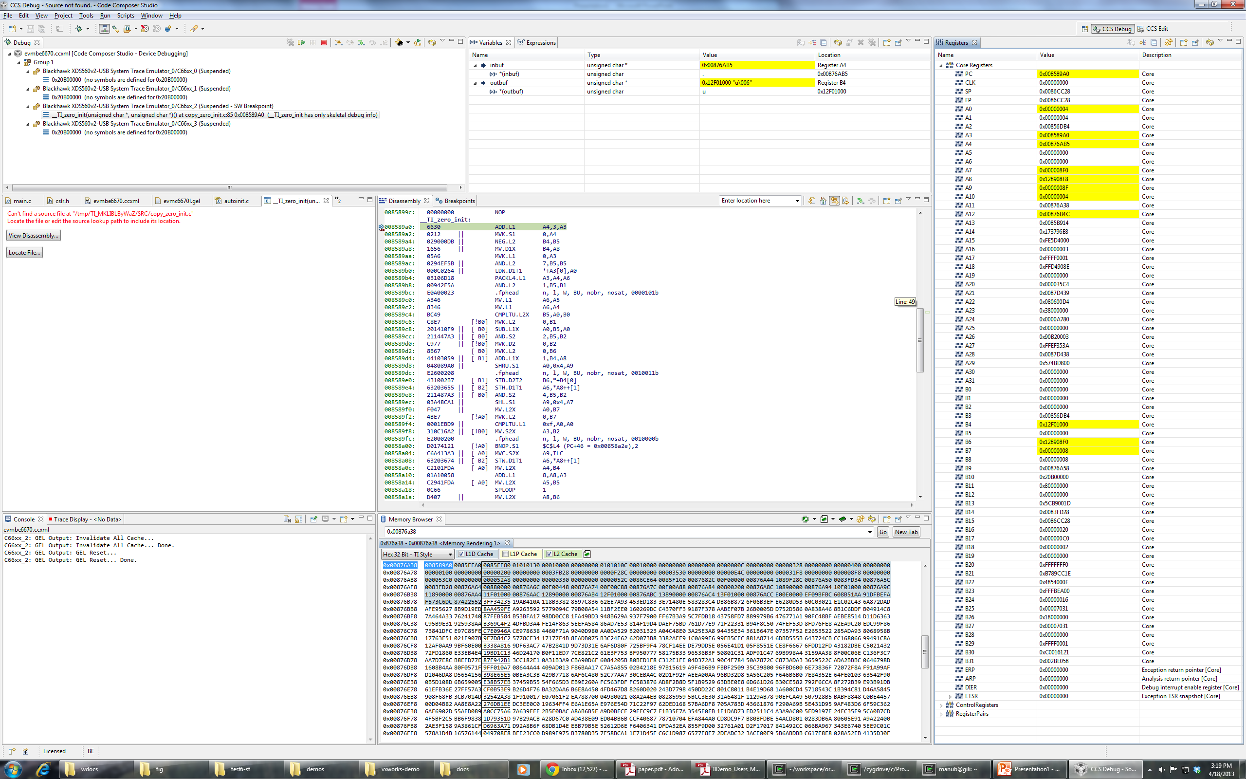

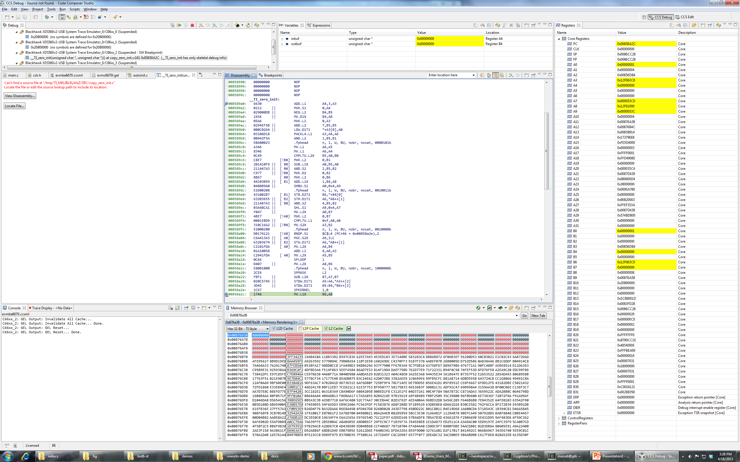

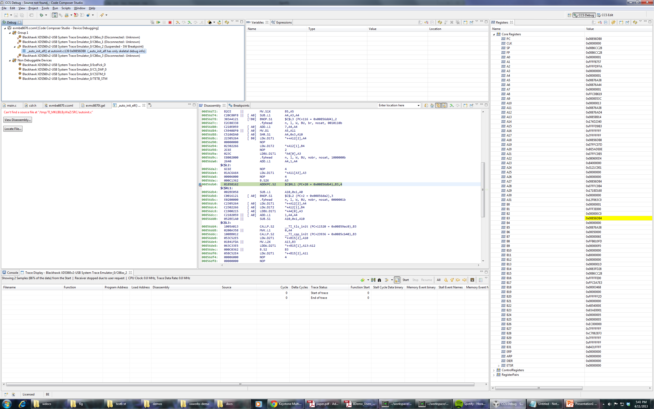

  • Okay, so I turned off run-to-main and then stepped through the code till it went into weeds. (I was hoping there would be better way than to step through, but anyway). After load, we are at _c_init00() at boot.c  0x0085B8E0. The next function to be called is _auto_init_elf(), which is the one that faults. I'm attaching three screen shots with disassembly and core register contents (PC, B3 and others) around the instruction that causes problems:
    00856db0:   01858162            ADDKPC.S2     $C$RL1 (PC+20 = 0x00856db4),B3,4
    As the screenshots show, after this instruction, PC gets set to 0x0000000.
    It is not one of my functions. This is compiler generated function. Could it be misbehaving because of some memory corruption caused by either earlier instructions in the same function or in _c_init00?
    On the functional simulator for 6670, the code runs to main on all cores and then breaks and waits for resume. On core 2 (the one faulting on silicon), after the particular instruction at 00856db0, PC gets set to 0x0085EFA0, which is __TI_decompress_rle24. I do, however, get the following warnings (shown only for core 2) in the run up to main:
    TMS320C66x_2: Warning: CGEM0_5: Memory Write not supported at address since memory configured as cache f00000 CGEM0_5: Memory Write not supported at address since memory configured as cache f00001 CGEM0_5: Memory Write not supported at address since memory configured as cache f00002 CGEM0_5: Memory Write not supported at address since memory configured as cache f00003 CGEM0_5: Memory Write not supported at address since memory configured as cache f00004 CGEM0_5: Memory Write not supported at address since memory configured as cache f00005 CGEM0_5: Memory Write not supported at address since memory configured as cache f00006 CGEM0_5: Memory Write not supported at address since memory configured as cache f00007 CGEM0_5: Memory Write not supported at address since memory configured as cache f00008 CGEM0_5: Memory Write not supported at address since memory configured as cache f00009 CGEM0_5: Memory Write not supported at address since memory configured as cache f0000a
    I am allocating data, including some const and some non-const globals, to L1DSRAM, which is what 0x0f000000 range is. However, I'm using the default GEL configuration which sets it as all cache, and then only setting L1D as SRAM in a setup function called from main. So at the time of auto initialization, that part of memory is still set as cache, which is what is probably throwing these warnings. Could that be the problem? If so, should I be modifying the GEL to match the configuration?
    Manu

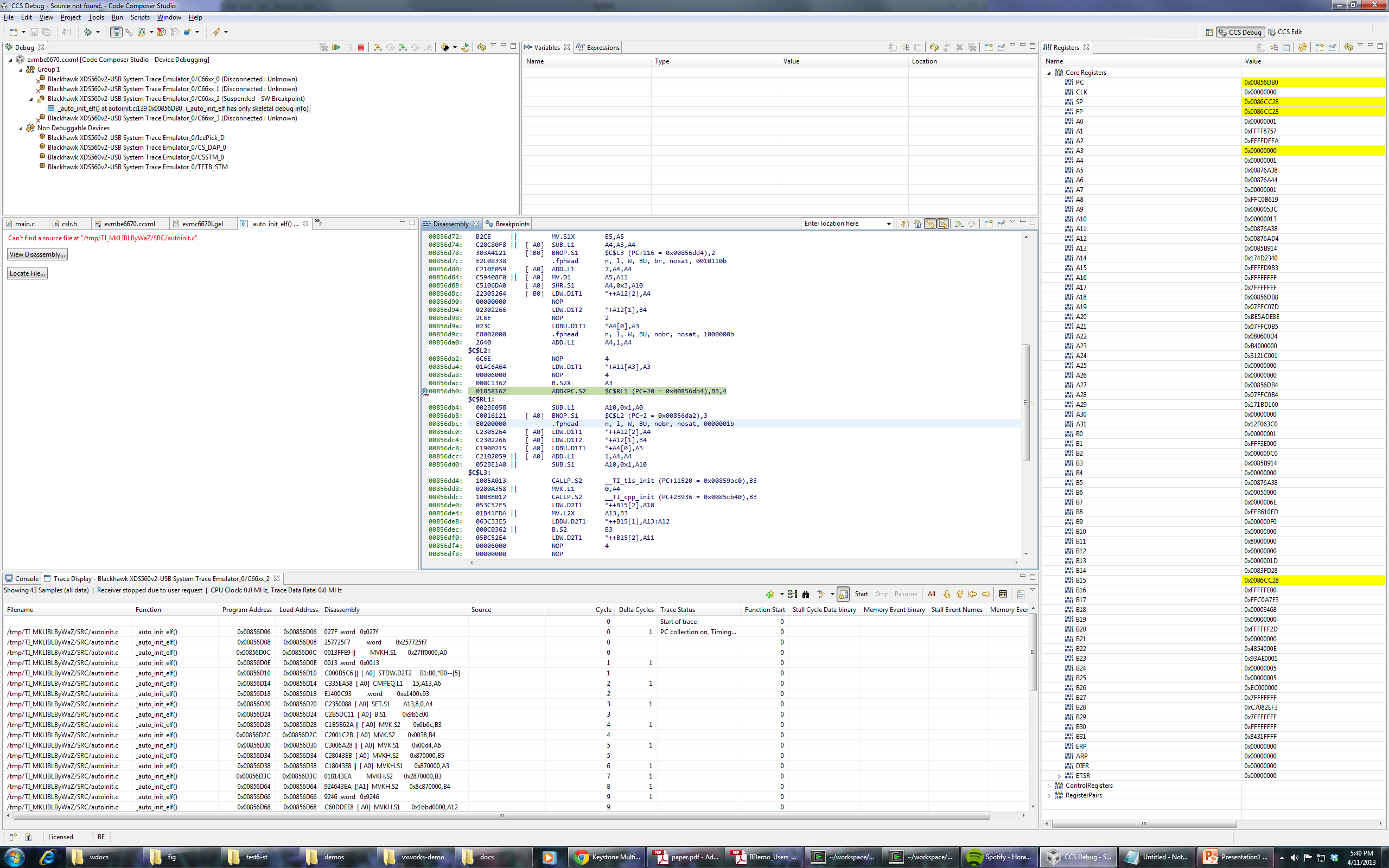

  • Take a look at the code just before the ADDKPC.  Here's what's there
      LDW  *+A11[A3], A3
      NOP  4
      B       A3
      ADDKPC
    At the point the ADDKPC occured, A3 is already = 0, It was from the load instruction (followed by the NOP4, means that the A3 write landed before the B A3 - Branch to address in A3.)  That's an invalid memory space (nothing is there.)
    You'll want to go back and look were that came from.  Reload put a breakpoint on LDW *+A11[A3], A3.  Now take the value in A11 + 4*A3 (you need the A3 prior to the load, it's used as an offset by A3 words to the value inside A11 at that point.)

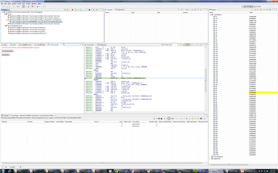

  • I went around following registers. A11 points to 0x00876A38, which is the location of  __TI_handler_table, which, according to my memory map output file looks like:
    LINKER GENERATED HANDLER TABLE
    __TI_handler_table @ 00876a38 records: 3, size/record: 4, table size: 12
    index: 0, handler: __TI_zero_init
    index: 1, handler: __TI_decompress_rle24
    index: 2, handler: __TI_decompress_none
    A3 is accordingly 0, 1 or 2, and ends up loading one of these functions. The reason why A3 loads 0x0000000 at one point is because 0x00876A38 memory gets written with zeroes. I narrowed down the part of code that writes that memory with zeroes, and it turns out to be an instruction in __TI_zero_init function. __TI_zero_init is called successively on different input and output buffers. A few of them go through fine and then one particular buffer's zero init ends up corrupting memory. I am attaching screenshots indicating that. The particular buffer for which this happens is highlighted below:

     The code for __TI_zero_init is supposed to come from copy_zero_init.c but I can't find it. It seems like it is linker generated as opposed to being part of the rts distribution. So I don't know what piece of C code is responsible for the corruption. I don't understand either why that is happening - gem2_dataL1DSRAM section doesn't overlap 0x00876A38. Why should that memory location get written to at all?
  • Thanks, at this point it sounds like it could be an issue w/ the C Initialization.  I'm moving this over to the C/C++ Forum and hopefully they can help more to resolve the issue.
    Chad

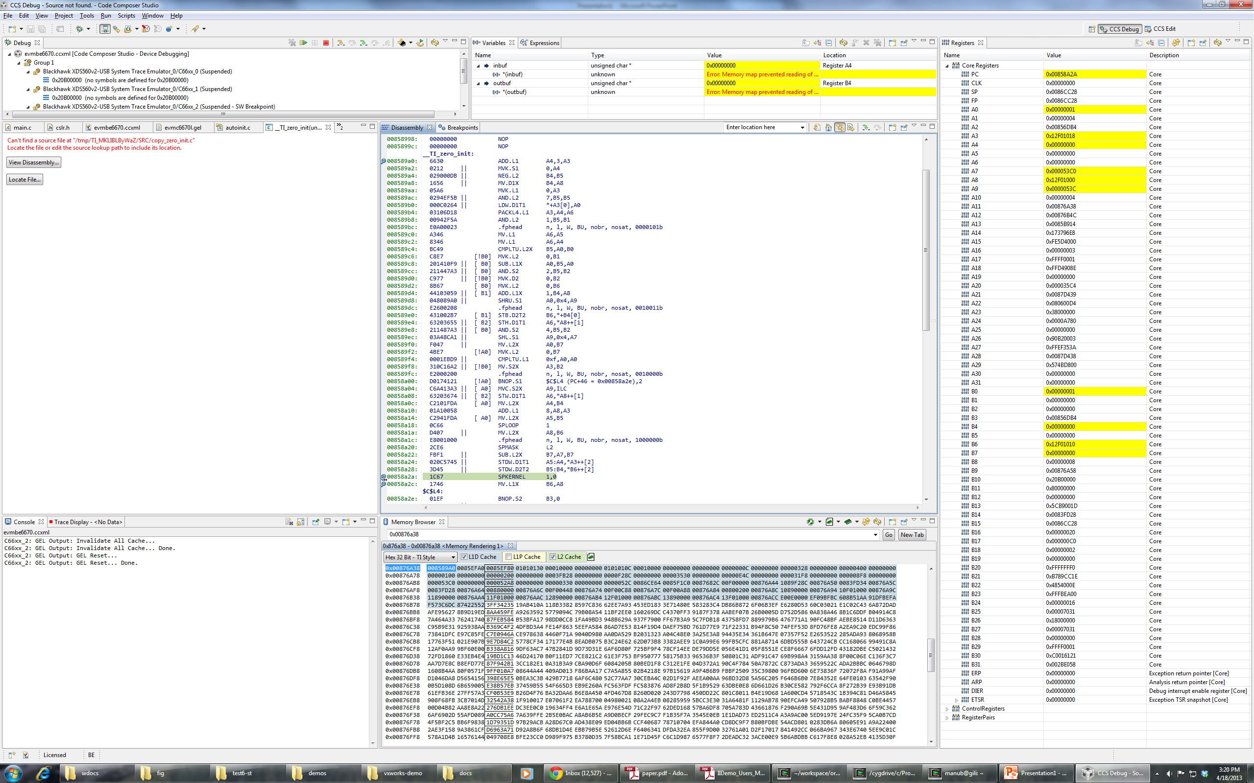

    The source code for RTS functions is in the file rtssrc.zip, found in the library directory.
    Your screenshots show __TI_zero_init having just gotten done writing to memory locations leading up to 0x12f063c0 (look at A3 and B6), but the memory window shows the memory locations leading up to 0x00876b80 were what actually changed.  This seems unlikely to be a compiler bug.  You mentioned earlier that you are mapping shared memory:

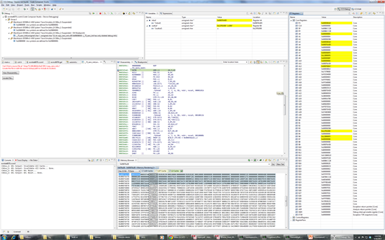

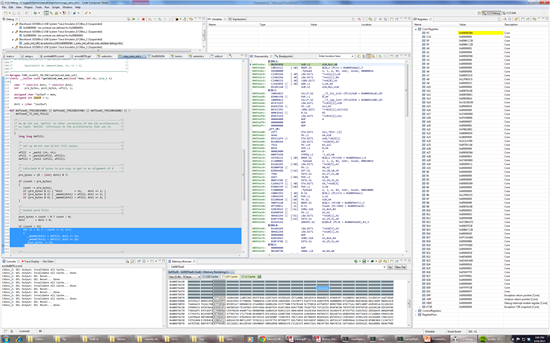

  • I stepped through assembly again and this time with rts code associated with it. The part of code that ends up writing to the 0x008.. range is highlighted in the attached screenshot. It comes from copy_zero_init.c. As a specific symptom, when the dst1 address (intended write address) was 0x12F055F0, 16B zero-write to that address zeroed out 16B starting from 0x00876AE0. I looked through that piece of the code too and it all seems fine.
    Shared memory mapping doesn't seem to be the cause. Shared memory is the 0x0c.. range, which I'm mapping to 0xe0.. range. Neither of those is in picture here.
    However, I do suspect that some L1-L2 cache interaction could be the problem, unless there are other bugs. 0x008.. range is L2 SRAM and 0x12F... is core 2's L1D SRAM. Could this be a hardware writeback from L1 cache to L2? Like I mentioned earlier, the GEL configuration is all defaults, so at the time of auto init, L1 is all allocated as cache. Only when init finishes and control comes to main, I call a setup function that sets L1D as memory.

  • All right, I think I solved it. It turned out to be what I guessed - the GEL initialization script needed to reflect the same L1 and L2 memory configuration, in terms of cache vs memory allocation, as I was linking with. My specific configuration was L1P all cache (default), L1D 4K cache and 28K SRAM (not default) and L2 all SRAM (default). GEL had L1D also set as 32K cache. That meant that my software-based reconfiguration of L1D as part cache, part memory was too late. Auto init functions were still functioning with L1D set as all cache, while they were working on memory allocated with the split configuration causing memory corruption due to hardware writebacks.
    Thanks for the cues though.
  • Yes, when I started reading through this this morning and I saw the writes to L1D space, I was about ready to ask you to dump the cache configuration registers.  L1D and L1P are configured as full cache by default, and you would need to disable them in your code before using them as SDRAM.
    Glad you worked through this.
