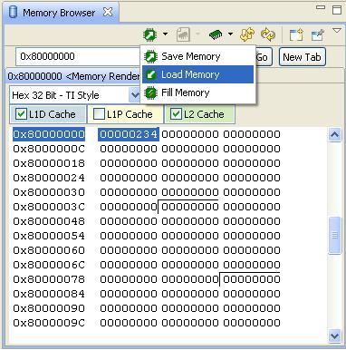

    One more thing. Is loading the dumps in the .dat file into the DDR3 memory your prime reason you using fopen, fread() ?? If so, you can directly load the contents of .dat file  into the required memory using "Load Memory" option in the Memory Browser.

    And I try to load the contents of a file into the required memory using "Load Memory"option

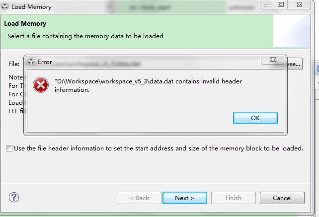

    in the Memory Browser. It's effective for some .bin file ,but for some .dat file following error
    occurred. Whether it is valid only for some file with specific header information ?
    how can I load my .dat file successfully ?

  • Hi Rui Guo,
    Where exactly did the .dat file was created from? Maybe the .dat file is not in its format(header information) for the CCS to detect the type of the .dat file.
    May be you can find more details in the below thread. Please revert back here after finding the solution to the issue.
    http://e2e.ti.com/support/development_tools/code_composer_studio/f/81/t/168292.aspx
