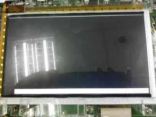

Hi all,
I tried to display 1080p on TI8148 EVK LCD using EZSDK 5.05.01.04 platform but image is distorted as shown in the image attached.
The following are the steps I did for this tryout:
modified load-hd-firmware.sh to modprobe vpss sbufaddr=0xBFB00000 mode=dvo2:1080p-60 i2c_mode=1
echo 0 > /sys/devices/platform/vpss/display1/enabled
echo 1080p-60 > /sys/devices/platform/vpss/display1/mode
echo 1 > /sys/devices/platform/vpss/display1/enabled
fbset -xres 1920 -yres 1080 -vxres 1920 -vyres 1080
./saFbdevDisplay
Is there any other settings needed?
Thank you for any help extended.

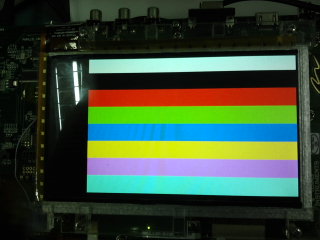

    Could you try:
    dm814x-evm login: root
    root@dm814x-evm:~# /etc/init.d/matrix-gui-e stop
    Stopping Matrix GUI application.
    root@dm814x-evm:~# /etc/init.d/pvr-init stop
    Stopping PVR
    root@dm814x-evm:~# echo 1:dvo2 > /sys/devices/platform/vpss/graphics0/nodes
    root@dm814x-evm:~# echo 0 > /sys/devices/platform/vpss/display1/enabled
    root@dm814x-evm:~# echo 720p-60 > /sys/devices/platform/vpss/display1/mode
    root@dm814x-evm:~# echo 1 > /sys/devices/platform/vpss/display1/enabled
    root@dm814x-evm:~# /etc/init.d/matrix-gui-e start
    Removing stale PID file /var/run/matrix-gui-e.pid.
    Starting Matrix GUI application.
    root@dm814x-evm:~# cat /sys/devices/platform/vpss/display1/mode
    720p-60
    root@dm814x-evm:~# cd /usr/share/ti/ti-omx/
    root@dm814x-evm:/usr/share/ti/ti-omx# ./saFbdevDisplay
    Fix Screen Info:
    Line Length - 3200
    Physical Address = 93a00000
    Buffer Length = 25165824
    Var Screen Info:
    Xres - 800
    Yres - 480
    Xres Virtual - 800
    Yres Virtual - 1440
    Bits Per Pixel - 32
    Pixel Clk - 29850
    Rotation - 0
    Let me know the result.
    Margarita
  • Hi Margarita,
    I had tried out those steps you mentioned and attached is the color bar displayed on the LCD.
    Its shifted to the right side of the screen.
