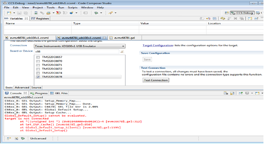

Can i get solution to the above shown error
Hi suresh ,
There should be no issues in loading the GEL file. Did you try testing the connection by clicking the "Test Connection" button?
After looking into the GEL, its not able to execute the function Set_DSP_Cache(). Its not able to access the cache config registers. Maybe because the device is not connected properly. Please try testing the connection.
Sud
Suresh,
The proper procedure to load the GEL and connect to the device is described here:
Rahul
