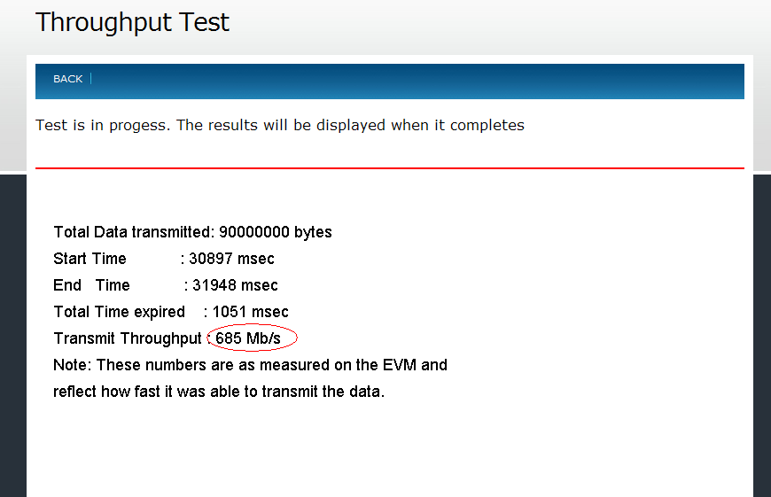

1. I measured hua demo of 6678 transmission speed as follows:
But only 8MB/s measured using the software on a PC, what is the reason for it?

  • Weifeng,
    This is UDP or TCP test? What is the software you used on PC to measure the throughput? Can you do a Wireshark capture, then you will see the actual time spent for the given amount of packets transmitted. That can be used to calculate throughput.
    Regards, Eric
  • Weifeng,
    One thing to note if you use Wireshark to calculate the throughput: the Wireshark may not capture all the packets at such high rate. However you can look at the IP header identification field to count how many packets Tx/Rx, this field is 16-bit, so need to consider the wrap-around.
    Regards, Eric
