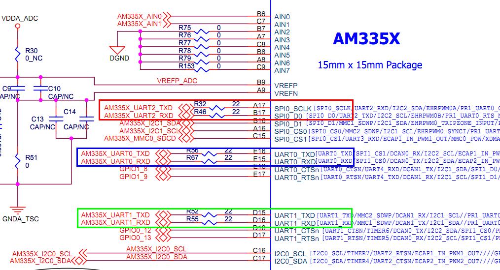

  • Hi Miroslav,
    I used 3 uarts below.
    Please refer to attached schematic.
    UART_0: Console E15/E16   (Blue Box)
    UART_1: RF_MCU D15/D16    (Green Box)
    UART_2: WCDMA MCU A17/B17 (Red Box)
    UART_0 and UART_1 are working.
    UART_2 is connected UART of WCDMA Modem.

  • Hi Kim,
    I noticed that your UART2_TXD and UART_RXD signals are swapped. Is it just a mistake in the schematic or are they really swapped? Please check this.
    Please copy and paste your pinmux configurations for UART0 and UART1.
    Miroslav
  • Dear Miroslav,
    That's right. It's our mistake on schematic.
    It will be changed.

    Miroslav
  • Hi Miroslav,
    I really appreciate your consideration for me.
    I'll check again.
    Thanks and Regards,
    Minsu Kim
  • Kim,
    Did you ever get this resolved?  I'm having problems with uarts 2 to 6, uarts 0 and 1 are working fine however.
  • Dear Sean,
    I solved this problem.
    But I didn't use CPLD on custom board.
    The custom board used UART0, UART1 and UART2 on profile 0.
    If you want to use another UART, Please refer to previous comment.
    If you have any question, Please post it here.
    Thanks and Regards,
    Minsu Kim
