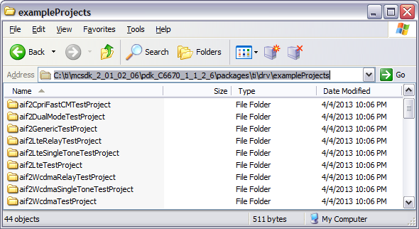

  • Hi Chenyi
    I assume from your post that you referred to an AIF example in PDK?
    Have you tried importing one of the AIF examples from C:\ti\mcsdk_2_01_02_06\pdk_C6670_1_1_2_6\packages\ti\drv\exampleProjects, as shown in the snapshot below, into CCS and testing it?
    If so, please let me know which project you are testing on your setup, so I can try and recreate your scenario here?
    Do you get the same result with the PDK example?
