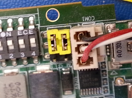

    This is most likely COM_SEL setting problem (OOB and POST should OK). To rule out the OOB/POST problems,
    1) Put the EVM into no boot mode, that is SW3 (OFF, on, on, on), SW4, SW5, SW6 all ON.
    2) Connect the serial cable supplied with EVM (one side is 3-pin, the other side is 9-pin serial) and set the COM-SEL. See the attached photo.
    3) Open a Hyper Term /Tera Term/Minicom with 115200, 8-N-1
    4) Load the post.out under C:\ti\mcsdk_2_01_xx_xx\tools\post\evmc6670l\bin and run, you should see something printed on the console.
    If you don't have JTAG emulator, then change step 1) to select OOB or POST based on the quick start guide, do 2) and 3) then power up.
    Let me know if you can make this work.
