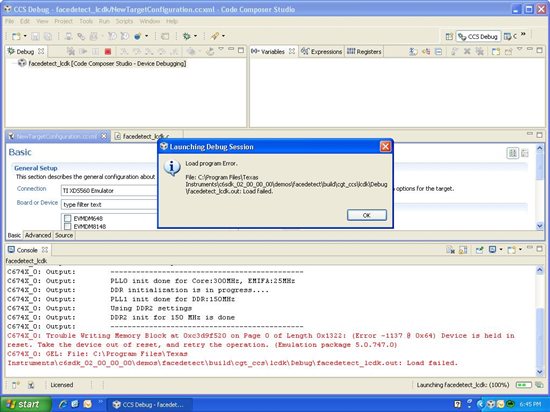

    6. If you notice any "Load program error" (attached) , press reset button on OMAPL138 LCDK board and relaunch the debug session in CCS.

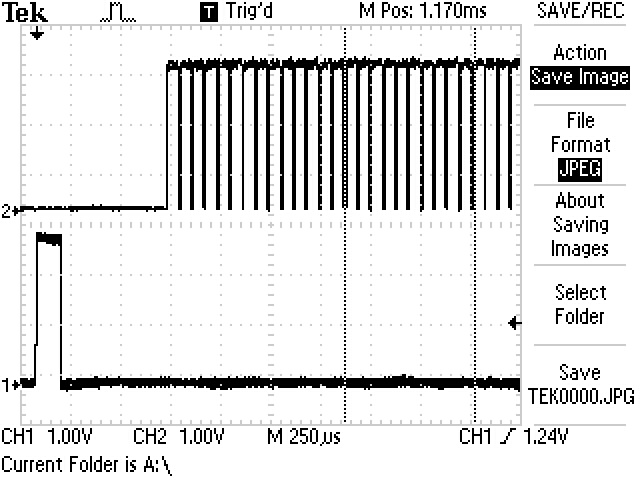

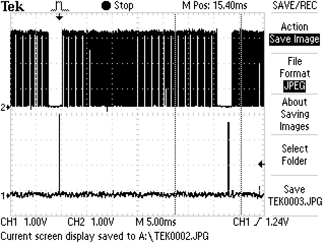

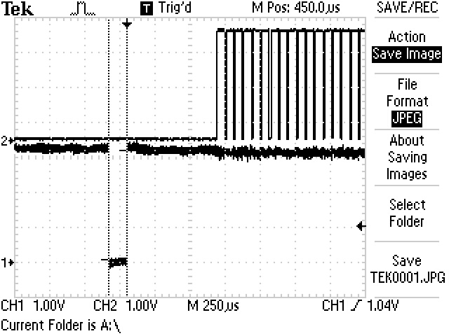

    I have replaced the PAL camera with a OV7962 sensor connected through the 36 way camera connector on the LCDK. I'm having issues when trying to acquire images from this sensor because the VPIF Channel0 interruption is not being triggered.
    What I've done is the following:
    1) Supply the OV sensor through 1, 2 and 3 pins in J16 connector.
    2) Generate an external 24MHz clock and fed it trough the sensor into the LCDK using the CAM_CLK pin (no. 9) in J16.
    3) Connect VSYNC, HSYNC and data bit signals in 11 to 24 in J16. I have measured with an oscilloscope VSYNC and HSYNC in the connector pins and seem to be OK (see images, VSYNC below, HSYNC above).
    These signals doesn't fit exactly the ones shown in page 1753 in spruh77a document, where it seems that both VSYNC and HSYNC signals have to be high to capture data. Because of this I have modified the bit 14 in C0CTRL register in order to invert the vertical pixel valid signal inseide the VPIF, by adding the correspodning code line in SetUpVPIFRx function in facedetect_lcdk.c.

  • Hi again,
    I've managed to modify sensor's output to generate an inverted VSYNC signal. Now the shape of the signal matches the expected one but the interrupt is not triggered.
    I've seen in the documentation that the expected vertical blanking time is at least 3 lines. The signal that I'm getting has only two lines width. Might this be the problem? Is it possible to reconfigure the VPIF to accept 2 lines vertical blanking time?

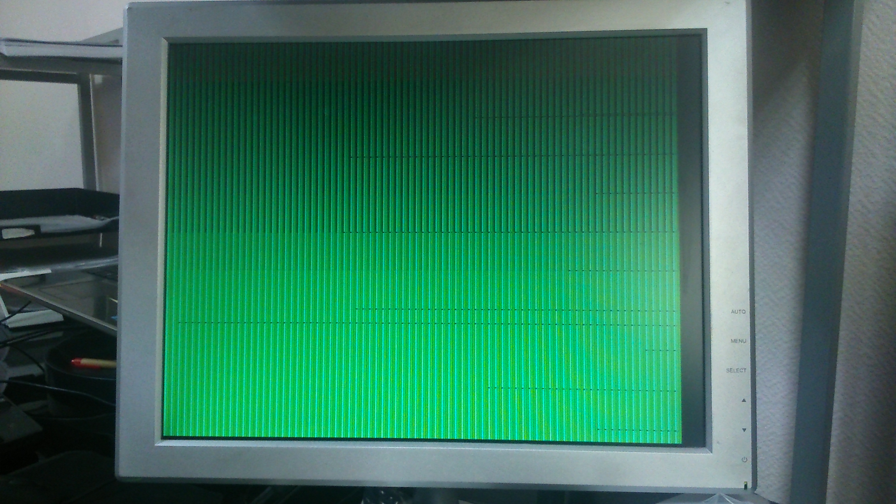

  • hi Erik
    i also have OMAPL138LCDK board  i want to run the facedtect demo i want to know which camera u have used for this purpose  i am using XDS100V2  emulator and i have ccs5.5 and where from u have got the coding for interfacing of camera and the image processing done on it please provide me the details
    thank you
  • Hello !!
    I have the some problem I modified the program as suggested
    http://e2e.ti.com/support/embedded/starterware/f/790/p/223776/810098.aspx
    But I have any thing in the screen.
    Could you please help me or attach the project that work.
    Think you
