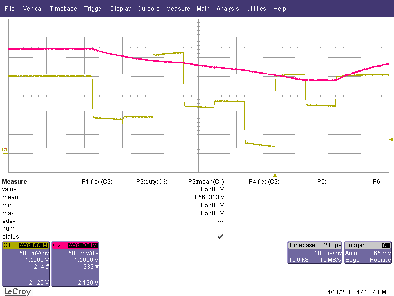

I then looked at one analog input voltage (C1 yellow in image below) , and found that ADC PIN is actually driving the net...
At the same time, VREFP (C2 magenta in image below) drops at every ADC step, then returns to its starting value:
It seems to me that cpu adc pins are not INPUT, but for some reason are acting as output.

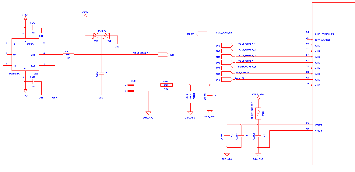

In following image you can see the (partial) schematic:
Is something related to wrong ADC configuration, or my CPU has some hardware trouble?

    It seems to me that CPU is faulty, because:
    - the same software runnin on ICE demo board works fine;
    - in our board VDDA_ADC is 2.7V, way over 1.8V (and well above absolute maximum ratings). Disconnecting VDDA_ADC from its power source, with nothing else connected on VDDA_ADC net, I still measure 2.7V! Maybe some bulk diode in cpu die is shorted... Still I can't guess why this happened.
  • Cpu was ok.
    The problem is that at least one analog input voltage exceeds VDDA_ADC (because of clamping diode to +3.3V):
    http://processors.wiki.ti.com/index.php/AM335x_Schematic_Checklist
    Touchscreen
    • recommend adding 0ohm resistor to VDDA_ADC in case you need to add a filter for noise on the ADC.
    • Check out the sampling voltage must not exceed the voltage of reference. Otherwise, it will affect the whole TSC_ADC system. (Ex: if you add pull up to 3.0V at the last four channel, this will lead to the abnormal work of the whole system, including the first four).
