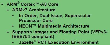

question about datasheet
there's description below in sprs614d.pdf
Q1. To use float point calculation by either NEON or VPF-v3, we can refer to  following in http://processors.wiki.ti.com/index.php/Cortex_A8#What_is_Neon.3F
  • arm-none-linux-gnueabi-gcc -O3 -march=armv7-a -mtune=cortex-a8 -mfpu=neon -ftree-vectorize -mfloat-abi=softfp
  • arm-none-linux-gnueabi-gcc -O3 -march=armv7-a -mtune=cortex-a8 -mfpu=vfp -ftree-vectorize -mfloat-abi=softfp
      But after I look http://doc.ironwoodlabs.com/arm-arm-none-eabi/html/getting-started/sec-armfloat.html , I found it's weird.
      The NEON and VPF-v3 is hardware accelerator, why the compiling argument isn't following but the above
  • arm-none-linux-gnueabi-gcc -O3 -march=armv7-a -mtune=cortex-a8 -mfpu=neon -ftree-vectorize -mfloat-abi=hard
  • arm-none-linux-gnueabi-gcc -O3 -march=armv7-a -mtune=cortex-a8 -mfpu=vfp -ftree-vectorize -mfloat-abi=hard
  • one more question
    Q2. when we use the linux command "top", does the field "CPU loading" include the loading of NEON and VPF-v3?
           if yes, how did I know the loading ofr each of them?
           if not, how do I know that?
