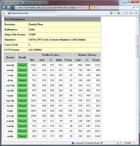

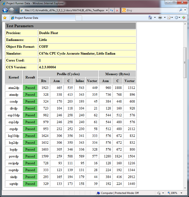

  • According to the test report of MATHLIB (mathlib_c674x_3_0_1_1), the test results are like below table.
    * powdp costs 259 cycles with "Asm".
    * rsqrtdp costs 28 cycles with "Vector".
    Os, can you explain about this table of test results?

  • Hi Hayden,
    ASM function benchmarks correspond to average cycle count taken by the function when called for a single value. Vector benchmarks correspond to average cycle count per sample in the vector when the function is iteratively applied to all the samples of the vector. This benchmark generally shows better results as the compiler parallelizes the code over the available DSP resources by software pipelining the code.

    I asked because "rsqrdp" instruction consumes only 2 cycles, but "rsqrtdp" at the table shows 123(Asm), 131(Inline) cycles.
    Why does it show big difference?
    Hayden

  • Hayden,
    _rsqrdp is a compiler intrinsic that directs the compiler to use a specific instruction. The RSQRDP instruction is explained in the C674x CPU & Instruction Set Reference Guide. It returns an approximate value for the reciprocal square root.
    The rsqrtdp is an implemented function that cacluates the full 64-bit-accurate value, not approximate, for the reciprocal square root.
    There may be a way to use iteration to get more accuracy with a few calls to the _rsqrdp intrinsic, but this may not be how the rsqrdp() function works.
    They return different accuracies, so my analogies above were incorrect.
    _rsqrdp is fast, while rsqrdp() is accurate.
    _rsqrdp is not easily portable, while rsqrdp() can be easily ported to another architecture.
