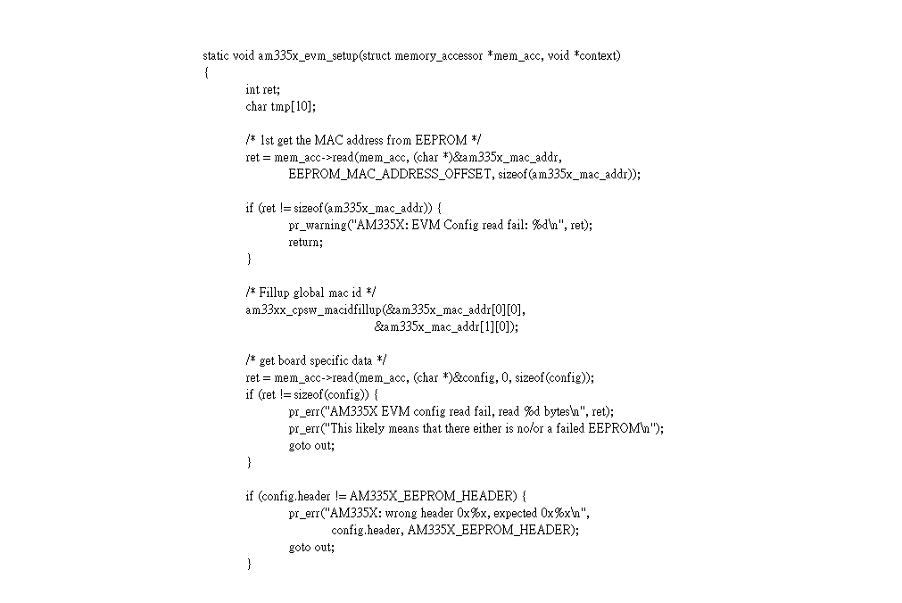

In my develeopent board has no daugher board. I use sd card to boot, but some problems in it.

[    1.071960] No daughter card found on AM335x EVM
[    1.076812] at24 1-0050: 32768 byte 24c256 EEPROM, writable, 64 bytes/write
[    1.092010] AM335X: wrong header 0xffffffff, expected 0xee3355aa
[    1.098297] The error message above indicates that there is an issue with
[    1.098297] the EEPROM or the EEPROM contents.  After verifying the EEPROM
[    1.098297] contents, if any, refer to the am335x_evm_setup function in the
[    1.098297] arch/arm/mach-omap2/board-am335xevm.c file to modify the board
[    1.098327] initialization code to match the hardware configuration
ÿ
how to solve the problem?
  • There is an EEPROM on the daughter board that is read by software. Also the CPLD board profile is read from the daughterboard. You will have to edit these two to get your EVM running without the daughterboard.
  • where can to edit these two?I find them in menuconfig or to find them in code?
    It's all happening in the am335x_evm_setup() function inside <linux_folder>/arch/arm/mach-omap2/board-am335xevm.c file.
    There are many ways to workaround this once you read the code.
    Miroslav

  • In my development board, it has only one eeprom. In the am335xevm board, it has three eeprom.
    Because I retains ethernet eeprom,the others is removed.
    so the am335x cannot exactly read the mac of eeprom,the machine will be halt.
  • I solve the above problem,but still have some problems
