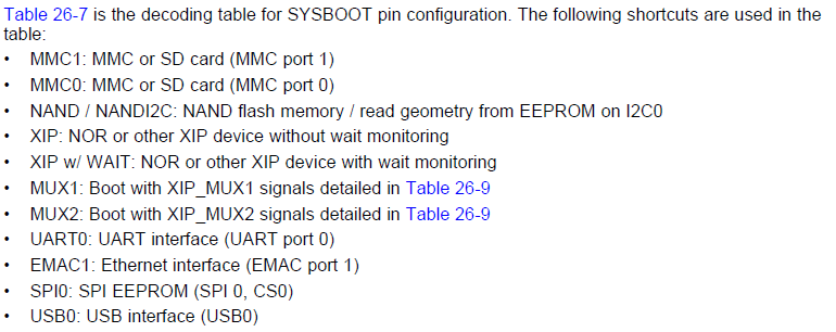

eMMC boot on AM335x
All information published  by TI (AM335x RefMan, datasheet, and Wiki eMMC boot, TI EVM Guide) only make references about booting from eMMC memory using the MMC0 or MMC1 interfaces.
There is no mention of booting from MMC2.
Are the eMMC boot configurations for MMC0 and MMC1 only based on TI's specific EVM design implementation and the associated Linux kernal configurations and NOT related to some internal TI AM335x deign limitation.
Based upon all docs that I've read, it appears that the only limitation to utilizing the MMC2 port for eMMC memory booting, is an update to the kernal boot code is needed to add support for MMC2 booting.  Please confirm if this is the case.
-Jaden
  • The ROM code of the AM335x can boot from the interfaces detailed in the AM335x Technical Reference Manual (SPRUH73) in Chapter 26, Table 26-7.
    MMC2 is not a supported interface to boot from initially.  This doesn't mean you can not connect a eMMC memory on it, but that particular interface will not be booted from.  Another non-volatile storage device on a supported interface will be required for the initial code which the ROM code in the AM335x can access.
    Below is a caption from the TRM section mentioned above.

  • Thomas, that statement in the TRM is misleading and will be changed.  You can boot eMMC from either MMC0 or MMC1, considering the limitations outlined in the TRM:
    26.1.7.5.2 System Interconnection
    Each interface has booting restrictions on which type of memory it supports: -
    • MMC0 supports booting from the MMC/SD card cage and also supports booting from
    eMMC/eSD/managed NAND memory devices with less than 4GB capacity.
    • MMC1 supports booting from eMMC/eSD/managed NAND memory device with 4GB capacity or
    greater.
    The restriction is a result of many eMMC devices not being compliant with the eMMC v4.41 specification.
    If you have the need to boot from two different card cages, many MMC/SD cards will boot from MMC1, but
    for maximum compatibility only MMC0 should be used to boot from the card cage. Similarly for maximum
    compatibility, booting from eMMC/eSD/managed NAND should only be performed on MMC1.
    Note that the above restrictions only apply to booting from each port. Drivers can be written for either port
    to support any desired interface.
    James
  • Thank you James for the answer. It covers my question fully, and I'm now satisfied that my design is fine as it is.
    Thomas
