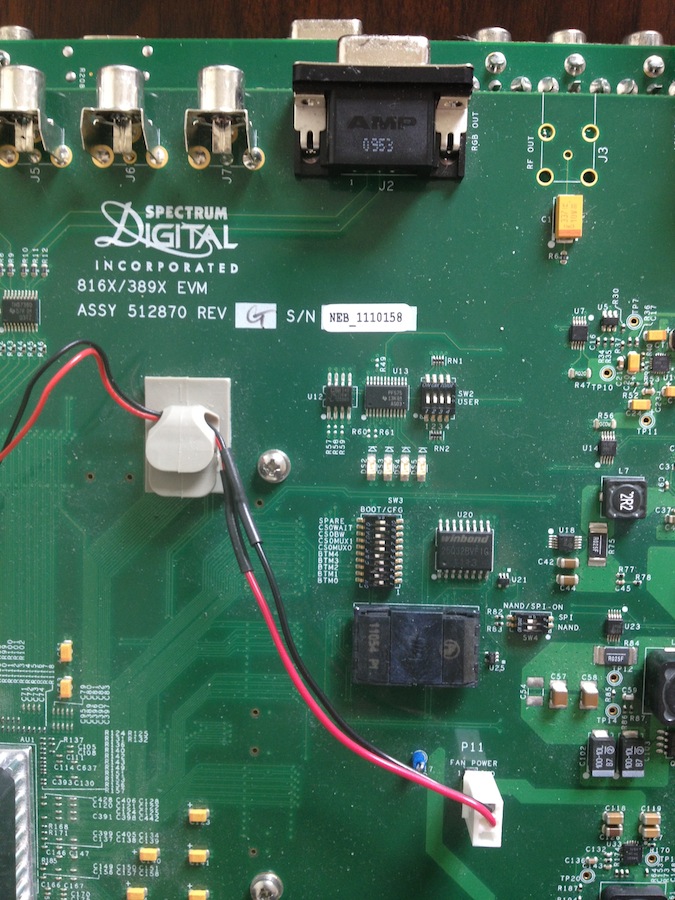

  • Can you please mention your EVM revision and BOOT MODE switch setting?
  • Hi Yogesh,
    We have two REV.G EVMs and the boot mode is set to [0010010010] ... i.e. CSOBW==1 to allow 16bit NAND bus.
    V2.00.00.24 RDK --- 0000010010 (working, note CSOBW=0)
    V3.00.00.00 RDK --- 0010010010 (working  with pre-built 3.0 images)
    V3.05.00.50 RDK --- 0010010010 (not working with pre-built 3.5 images)
    As noted, using 3.5 kernel and the 3.0 boot loader does work correctly.
    -- Leon | VOCAL Technologies

  • Leon,
    We had issue with EVMs below Rev C. It is unfortunate to see this. I will cross verify uboot of RDK 3.5 and get back to you.

  • Leon,
    I am able to bringup DM8168 Rev C EVM with pre-built RDK 3.5 images (DVRRDK_03.50.00.05_Binary\ti816x_evm folder). Please find attached log, I dont observe any issue that you have mentioned.  Please compare the log with your log and let me know the observation. At the end of the log I have shown output of 'nand info' command and my bootargs.

    I flashed pre-built uboot through CCS (using nand-flash-writer.out and DM816x.gel) and I used tftp for uImage and nfs as a file system and all seems to be ok. I suspect the switch setting for NAND detection issue in your setup. Can you upload a picture of you BOOT MODE switch (SW3) and SW4?
  •  Good Afternoon Yogesh,
    Unfortunately I don't share your results.
    ## perhaps we're not using the same images
    dev1@BRYANT:/project/leo/DVRRDK_03.50.00.05/pre_built_binary/ti816x_evm$ pwd
    dev1@BRYANT:/project/leo/DVRRDK_03.50.00.05/pre_built_binary/ti816x_evm$ ls
    ubi_128_DM816X_TI_EVM.img uboot_NAND_DM816X_TI_EVM uImage_DM816X_TI_EVM
    dev1@BRYANT:/project/leo/DVRRDK_03.50.00.05/pre_built_binary/ti816x_evm$ md5sum *
    847da1a228b26cc1a6dd887206fd7424 ubi_128_DM816X_TI_EVM.img
    2dce1297d9e13b7e97d816d3854b6610 uboot_NAND_DM816X_TI_EVM
    5e5dc446b21dca982bff71a4b0245dfc uImage_DM816X_TI_EVM
    ## perhaps we're not flashing u-boot the same way
    nand erase ;
    dhcp ; setenv serverip 10.1.1.45 ;
    mw.b 0x81000000 0xFF 0x00260000 ;
    tftp 0x81000000 uboot_NAND_DM816X_TI_EVM ;
    nand erase 0x0 0x00260000 ; nandecc hw 2 ; nand write.i 0x81000000 0x0 0x00260000;
    reset
    ## perhaps we've setup the board differently
    dhcp; setenv serverip '10.1.1.45';
    setenv bootargs 'mem=256M console=ttyO2,115200n8 root=/dev/nfs rw nfsroot=10.1.1.45:/srv/nfsroot/dm8168_evm350 ip=dhcp vram=20M notifyk.vpssm3_sva=0xBEE00000 ddr_mem=1024M' ;
    setenv bootfile 'uImage_DM816X_TI_EVM' ;
    setenv bootcmd 'dhcp; setenv serverip 10.1.1.45; tftp 0x81000000 uImage_DM816X_TI_EVM; bootm;'
    saveenv
    reset
    For your reference, I've attached the full log of one of the EVMs I tested this on.
    ## perhaps we're not flashing uboot the same way
    	nand erase ;
    	reset
    	saveenv
    	reset
    ## still have issue
    	<bootlog.snip>
    	m25p80 spi1.0: found w25q32, expected m25p80
    	m25p80 spi1.0: w25q32 (4096 Kbytes)
    	Creating 4 MTD partitions on "spi_flash":
    	0x000000000000-0x000000040000 : "U-Boot"
    	0x000000040000-0x000000042000 : "U-Boot Env"
    	0x000000042000-0x0000002c2000 : "Kernel"
    	0x0000002c2000-0x000000400000 : "File System"
    	omap2-nand driver initializing
    	No NAND device found.
    	</bootlog.snip>
    -- Leon Kok | VOCAL Technologies
  • Afternoon Yogesh,
    To help further clarify, on the same EVM, with the same UBOOT_ENV and same (tftp'd) KERNEL, using the u-boot from the EZSDK it all seems to work.
    dev1@BRYANT:/srv/bsp/ti-ezsdk_dm816x-evm_5_05_02_00/board-support/prebuilt-images$ md5sum u-boot.noxip.bin
    188cf0d5fd5e3affd8c630f896ddeb17 u-boot.noxip.bin
    dev1@BRYANT:/srv/bsp/ti-ezsdk_dm816x-evm_5_05_02_00/board-support/prebuilt-images$ cp u-boot.noxip.bin /tftpboot/uboot_NAND_DM816X_TIEZSDK
    ## using the
    nand erase ;
    tftp 0x81000000 uboot_NAND_DM816X_TIEZSDK ;
    reset
    <snip>
    NAND device: Maf ID: 0x2c, Chip ID: 0xca (Micron, )
    erasesize: 0x20000, writesize: 2048, oobsize: 64
    Creating 6 MTD partitions on "omap2-nand.0":
    0x000000000000-0x000000260000 : "U-Boot"
    0x000000260000-0x000000280000 : "U-Boot Env"
    0x000000280000-0x000000580000 : "U-Boot Logo"
    0x000000580000-0x0000009c0000 : "Kernel"
    0x0000009c0000-0x00000d1e0000 : "File System"
    0x00000d1e0000-0x000010000000 : "Reserved"
    </snip>

  • Leon,
    I see you are flsashing images from DVRRDK_03.50.00.05/pre_built_binary/ti816x_evm and I'm flashing from DVRRDK_03.50.00.05_Binary/ti816x_evm, as you said we must have different binaries can you check DVRRDK_03.50.00.05_Binary\ti816x_evm on your end? Ideally these should have been same. Meawhile I will look at rest of the logs and parameters that you have shared. Thanks for the detailed info.
  • Morning Yogesh,
    I don't have a 'DVRRDK_03.50.00.05_Binary/ti816x_evm' directory -- do we perhaps have a different version of 03.50.00.05 ?
    Running the 'installjam' DVRRDK_03.50.00.05--Linux-x86-Install.bin (feb3593c2c9f5f47c5bd9c3198e61d43) and extracting the resulting ./dvrrdk/DVRRDK_03.50.00.05.tar.lzma (9b9d1aa619b3a696548bfe172fdb1f51) means I have the following tree:
    dev1@BRYANT:/project/leo/nand$ ll
    total 682M
    drwxrwxr-x 3 dev1 dev1 4.0K May 13 09:22 dvrrdk/
    -rwxr--r-- 1 dev1 dev1 682M May 13 09:20 DVRRDK_03.50.00.05--Linux-x86-Install.bin*
    dev1@BRYANT:/project/leo/nand$ tree -d -L 4
