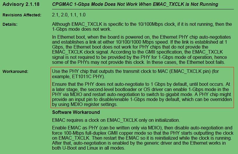

  • let me clarify one more thing,  did you check if you follow walkaround below in sprz329.pdf ?
  • I'm using the ET1011C PHY which provides a clock on that signal line even when in 1Gbps mode.  I've checked the driver code (which is the same code used by the EVM) in drivers/net/davinci_emac.c and it sets the PHY to autonegotiation and full duplex and it also turns the clock on.  I believe this should be sufficient.  At least it follows the requirement as described by TI and by others on this forum.  I'm trying to do this with autonegotiation; I haven't attempted to force it to 1Gbps.
