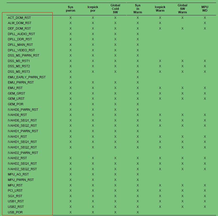

hi friends,
by chekcing following in sprugx8.pdf
do you know which RST inside red rectangular(like DEF_DOM_RST, ACT_DOM_RST) cause the real ARM reboot?
hi friends,
Hi Jack,
If you refer to the ARM in the Cortex-A8 MPU subsystem, the reset signals are MPU_AO_RST, MPU_PWRN_RST and MPU_RST. See TRM, section 18.5.5 MPU Subsystem POR Sequence and section 18.5.6 MPU Subsystem Warm Sequence.
Pavel
As the Cortex-A8 ARM is in the always-on power domain, the ALW_DOM_RST should also reset the ARM. See DM816x datasheet:
7.1.2 Power Domains
Always-On Domain
The always-on domain contains all modules that are required even when the system goes to standby mode. This includes the host ARM and modules that generate wake-up interrupts (for example, UART, RTC, GPIO, EMAC) as well as other low-power IOs.
Pavel
