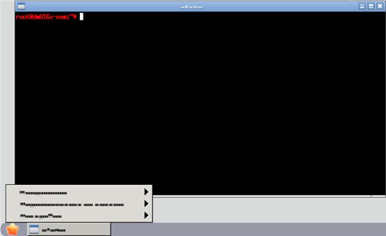

I have a strange problem with xorg video driver:
When in my xorg.conf option "NoAccel" is set to "true",  then everything is displayed correctly, but it's slow.
When I comment this line and restart X, everything is faster, but, for example, openbox window titles are not displayed correctly. This issue only affects fonts.
Inside window everything looks good. See attached screenshot:
There is window of xterm and fbpanel.
I use custom board, based on c6a186x; file system, u-boot and kernel from EZSDK 5_05_02_00. Driver in xorg.conf is set to "pvr".
Can someone tell the reasons of this behavior or how to solve the problem?
Thanks.

  • Thanks for your reply, but I think you do not understand what the problem is.
    The "NoAccel" option was set to "true" during some of the tests due to problems with memory settings.
    But now I need to use graphic acceleration and have a problem, that I described above. Maybe I just need something to install..
    By the way, Qt demos does not work correctly with X11 on my system.
    Anyway, thank you for provided links.

  • Pavel,
    I already have read and successfully completed Xorg build and execution. I also have read SGXDbg wiki page.
    The main problem is the use of acceleration.
    I use Graphics SDK from ezsdk, is it normal or should I upgrade to a newer version?
