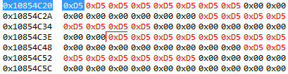

The problem is, after enabling the transfer, I get this:
I'm getting the same data both in Ping and Pong buffers. Why? I've set the bcnt and BCntReload to 32 bytes, why am I receiving 64 bytes of data?
And, the second problem is, from the second transfer onwards, everything "fall apart" and I start to receive my data on random positions inside the RXBuff.
What am I missing? Am I configuration something wrong in the DMA? Do I need to change something at the callback function to work with Ping-Pong buffers?

  • Hi Chad, thanks for your attention.
    After each Frame Sync, I expect only 32 bytes of data. And the same data each time (8 bytes 0xD5, 8 bytes 0x00, 8 bytes 0xD5, 8 bytes 0x00)
    That double data (ping/pong buffers) that I displayed before occurred after only one Transfer Request.
    I don't know if I understand the ping/pong buffer mode in EDMA correctly. I believe that the sequence is:
    Request Transfer -> Ping buffer fills (linking to pong occur) -> Request transfer -> Pong buffer fills (linking to ping occur).
    Is something wrong? Or am I supposed to expect after each Transfer Request that both ping and pong are filled? I just couldn't understand why after one TR, I got 64 bytes of data instead of the 32 I programmed.

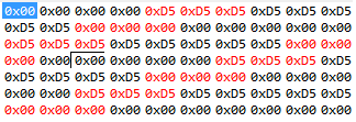

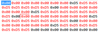

    And after the second TR, the sequence starts to vary, let me show you:
    1st TR:
    2nd TR:
    3rd TR:
    And so on, the data just start to fill random positions inside the RXBuff.

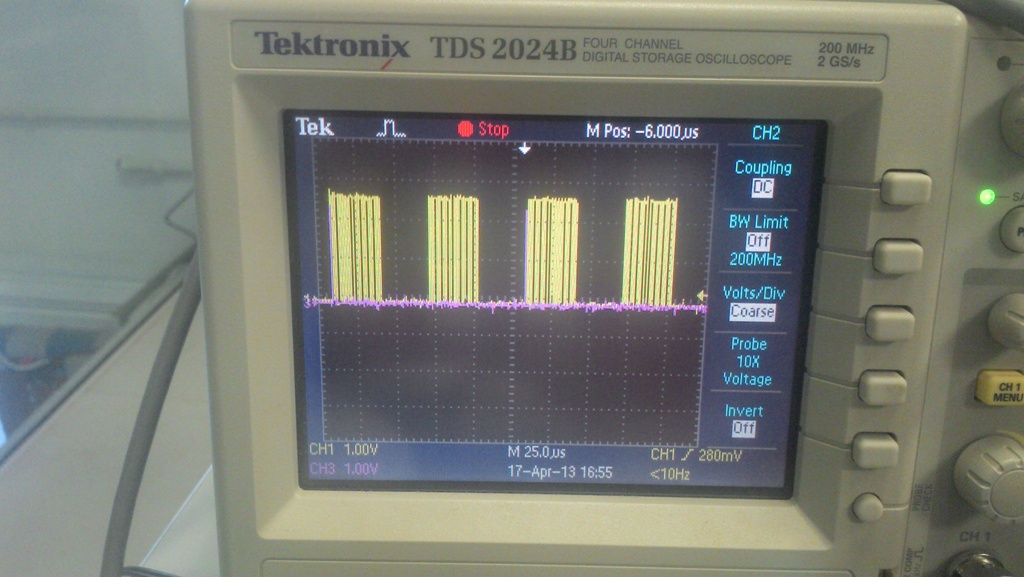

  • Have you put an Oscilliscope on the McBSP to make sure you're not getting more frame sync's than you're actually expecting?  Also, making sure the data sequence relative to the Frame Sync's are correct?
    Chad
  • Hi Chad,
    Yes, in fact I have an oscilloscope connected to the McBSP port, I'll show you the data:
    I don't know if it's very visible, but the FS are the thin purple lines. Everything entering the RX port is ok. The FS is 8 kHz and comes from an External source.

  • It actually looks like it's doing what you're telling it to do.
    The Linking (LINK of 0x4820 then 0x4800) between the first and second PaRAM values you show indicate that it's copied over the other PaRAM entry and kept going.
    The fact that you're continuing to send Frame Sync's means that the McBSP will continued to send Rx Events, which means it will continue to trigger transfers.
    This is what linking is all about, once you finish one, it links and pulls in the PaRAM entry for the next.  Once it gets an Event it triggers that next transfer.
    If you want to see this only go into one of the buffers, then only send one frames worth of data down the McBSP instead of continuing to send frame after frame after frame which is what your O-scope capture is showing you're doing.
    Chad

  • Hi Chad,
    Ok, now I get it. I expected that after each TR, the address would be exactly in the RXBuff initial address or (RXBuff + FRAME_SYNC). But if the transfer is continuous, makes sense that it'll keep changing as it is receiving data continously.
    This "forcing" I did was just now, upon seeing the address continuous changing at the PARAMs setting. I wasn't doing that when I started this topic, sorry if I made it look like that.
    About the EDMA configuration: no, I'm not reconfigurating it, I just do it once, one time for TX and one time for RX. I receive and transmit data in this line of code:

  • Well, I made some more tests and here something I discovered:
    After receiving the data in the Rx port, I write a stream of numbers (from 0x00 to 0x20) in the TX port. I did this to analyse the data being transmited in the oscilloscope and found out some things:
    - The TX is not synchronized with the Frame Sync;
    - The transmission is not continuous;
    And, the most important one: after setting a breakpoing in my code and analysing the RXBuff, I found something like this:
    0xD5 0xD5 0xD5 0xD5 0xD5 0xD5 0xD5 0xD5   0x0A 0x0B 0x0C 0x0D 0x0E 0x0F 0x10 0x11 0xD5 0xD5 0xD5 0xD5 0xD5 0xD5 0xD5 0xD5 0x12 0x13 0x14 0x15 0x16 0x17 0x18 0x19
    The TX port is writing in the RX port! I don't have a single idea why this happens. My EDMA configuration is apparently right and both RX and TX addresses are distant from each other.
    Have you ever ran into something like this before?
