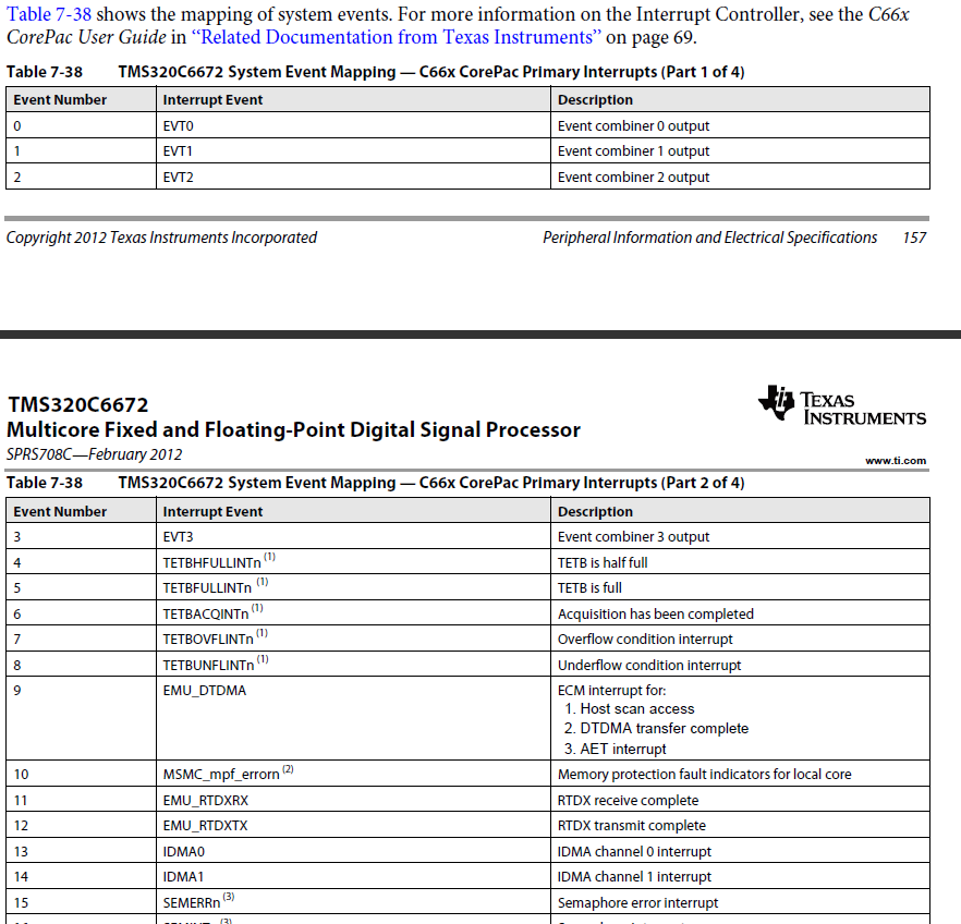

Section 7.9 in TMS320C6672 data maual illustrates that the event number of GPINTn is 90 and 'n'  is the CorePac number.
Does that mean it is impossible to make GPIO2 ~ GPIO7 as interrupt sources on TMS320C6672 board?
Or, if there is a way, please let me know.
Thanks.
  • No, GPIO2-7 still have their own separate events as well (Event #8-13.)
    The Event 90, was to have a common Event number for a 'Local CPU interrupt' that could be targeted by specific GPIO's w/o the extra work of remapping - which could have been done.  That said, each of the GPIO's 0-7 are also tied to specific event numbers and can be used for interrupts.

  • Dear Chad,
    Thank you very much for your reply.
    But, there is something different from DSP6672 datasheet in your reply.
    I couldn’t find separate events for GPIO 0 ~ 7.
    The data sheet I have says:
    Have I misunderstood something?
    Best Regards.
  • They are on the secondary events CIC3.  See table 7-41.
    Chad

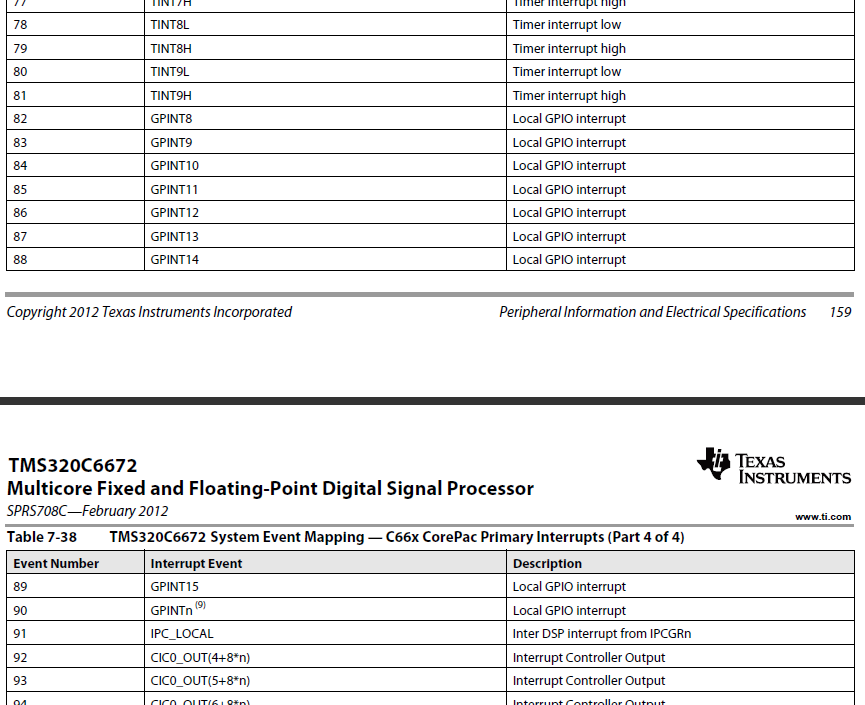

  • Please take a look at the footnote for event 90 in the table "CorePac[n] will receive GPINTn".
    In C6678, we have 8 cores and GPIO 0~7 will be connected to Core 0~7 individually by the same event #90.
    But in C6672, since we have only two cores, only GPIO 0&1 will be connected to Core 0&1. GPIO 2~7 will not connected to Core 0&1 based on our interrupt mapping in C6672.
    In CIC3, we have GPIO 0~15 events, but they are connected to EDMA3CC0 and HyperLink, not to CorePac.
    So please use GPIO 0,1 and 8~15 in C6672 device as the GPIO event source.
