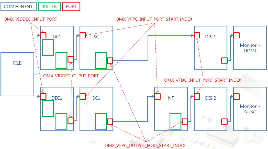

I tried creating a separate pAppData instance for each decode channel.
It's done.

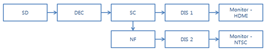

In my opinion, the above methods is :
used two pAppData
but I want to use scalar just like dei.
just use one instance(pAppData).

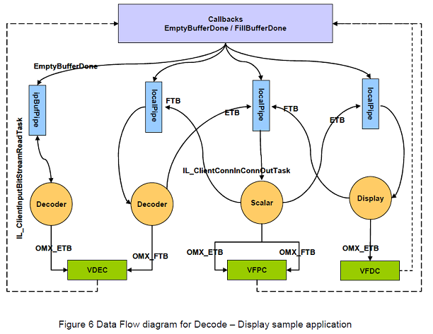

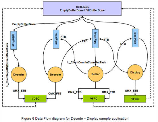

Decode - Display data flow is below :

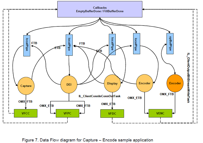

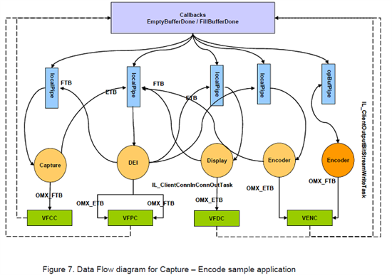

And Capture - Encode Data flow :

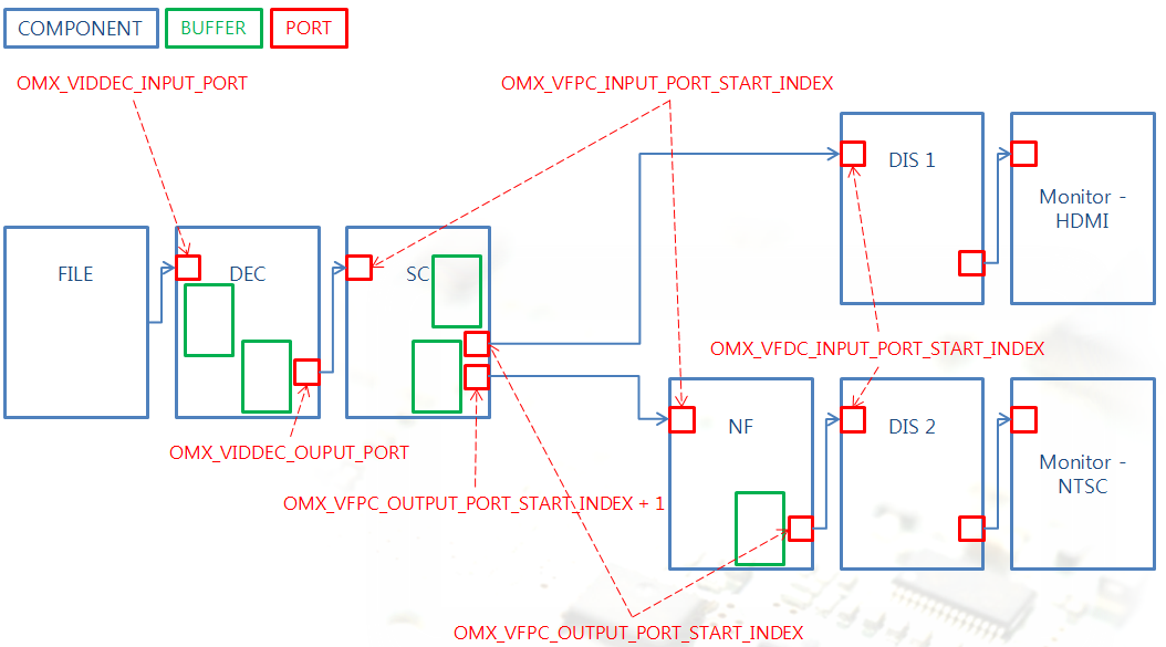

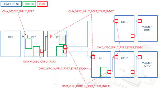

Set two output ports on scalar,
first output port is connect to 'display 1',
second output port is connect to noise filter.
just like below :
It is right?
allocate buffer, set port index, etc...
Do you understand?
