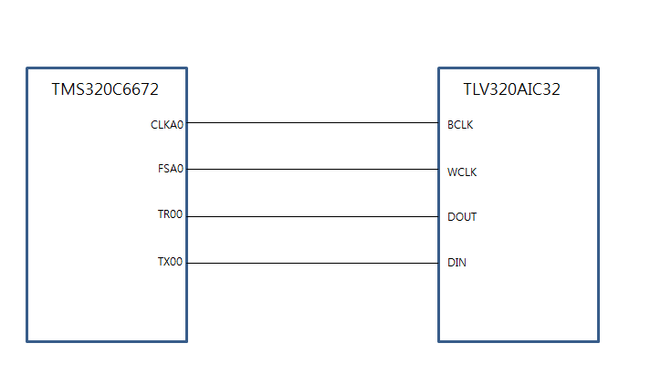

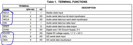

Hi, I want to use TLV320AIC32 and TMS320C6672 processor.
I don't know how can I connect 2 ICs.
And, how make the clock signal MCLK, WCLK, BCLK for TLV320AIC from DSP processor?
Any suggestion will be helpful to me.

Choi Su,
The C6672 does not have an interface for direct connection to a TLV320AIC32. You would need an FPGA to connect one of the available interfaces like TSIP or SGMII Ethernet. The attached white paper describes a method for using TSIP.
0412.Audio Channel Transport Over TSIP.pdf
Tom
Choi,
The white paper provided describes use of FPGA logic to work out the details. I expect this will be needed. The TSIP clock must be an input. Does the AIC device drive clock? Does the AIC device drive a compliant frame pulse? Logic will be needed to create the clock and frame pulse. The data streams may connect directly. Please post the expected AIC signals and whether they are inputs or outputs.
Tom
