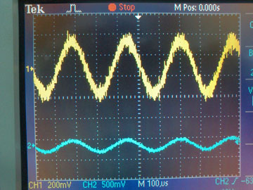

    But now I'm facing another problem.  after I can make the DAC work without for loop, I tried to put IIR filter between the ADC and DAC code, and again, I can't get the result of the DAC after I put the filter equation.
    Then I tried to simplify the equation by just averaging the signal, but the DAC produce strange signal, and it doesn't looks like the source signal.
    here is the code:
    while( ! ( mcasp->regs->SRCTL5 & 0x10 ) ); // Check for Tx ready
    mcasp->regs->XBUF5 = 0;
    while (1)
    while ( ! ( MCASP1_SRCTL0 & 0x20 ) );
    x0 = MCASP1_RBUF0_32BIT;
    x0 = x0 >> 16;
    y0 = (x0 + x1 + x2 + x3) / 4 ;
    x3 = x2;
    x2 = x1;
    x1 = x0;
    y0 = y0 << 16 | 0x00000000;
    while ( ! ( MCASP1_SRCTL5 & 0x10 ) );
    MCASP1_XBUF5_32BIT = y0 ;

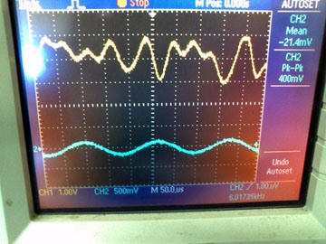

     if I don't devide the equation by 4 so the equation become y0 = (x0 + x1 + x2 + x3) , the DAC can work and it produce signal with  bigger amplitude than the source signal, but if I devide it by 4 (like this : y0 = (x0 + x1 + x2 + x3) / 4 ),  the signal become strange and doesn't like the source signal
    does I make any mistake?
    shouldn't it back to the original signal if I devide it by 4?
    Here is the result if I don’t devide it by 4:

    And this the result if I devide it:
    Yellow:  DAC signal
    Blue : source signal
    Any idea?
    please I need your help
