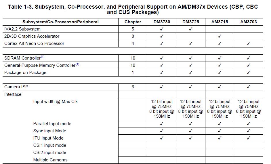

Please find the picture below. Table 1.3 from TRM describes the features of DM37x.
By the way, MIPI CSI 1/2 are uncheched in the table. But CSI is mentioned several times over TRM.
I wonder if CSI is supported really.
