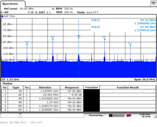

AM335x generate a harmonics of 6MHz emission during the VTP logic working on dynamic update mode
When the VTP logic working on dynamic update mode, I find a harmonics of 6MHz emission by using a spectrum analyzer on the AM335X EVM and Beaglebone board. For your reference,here is a picture we captured.
Is this a known issue, or is there anyway to avoid it?
