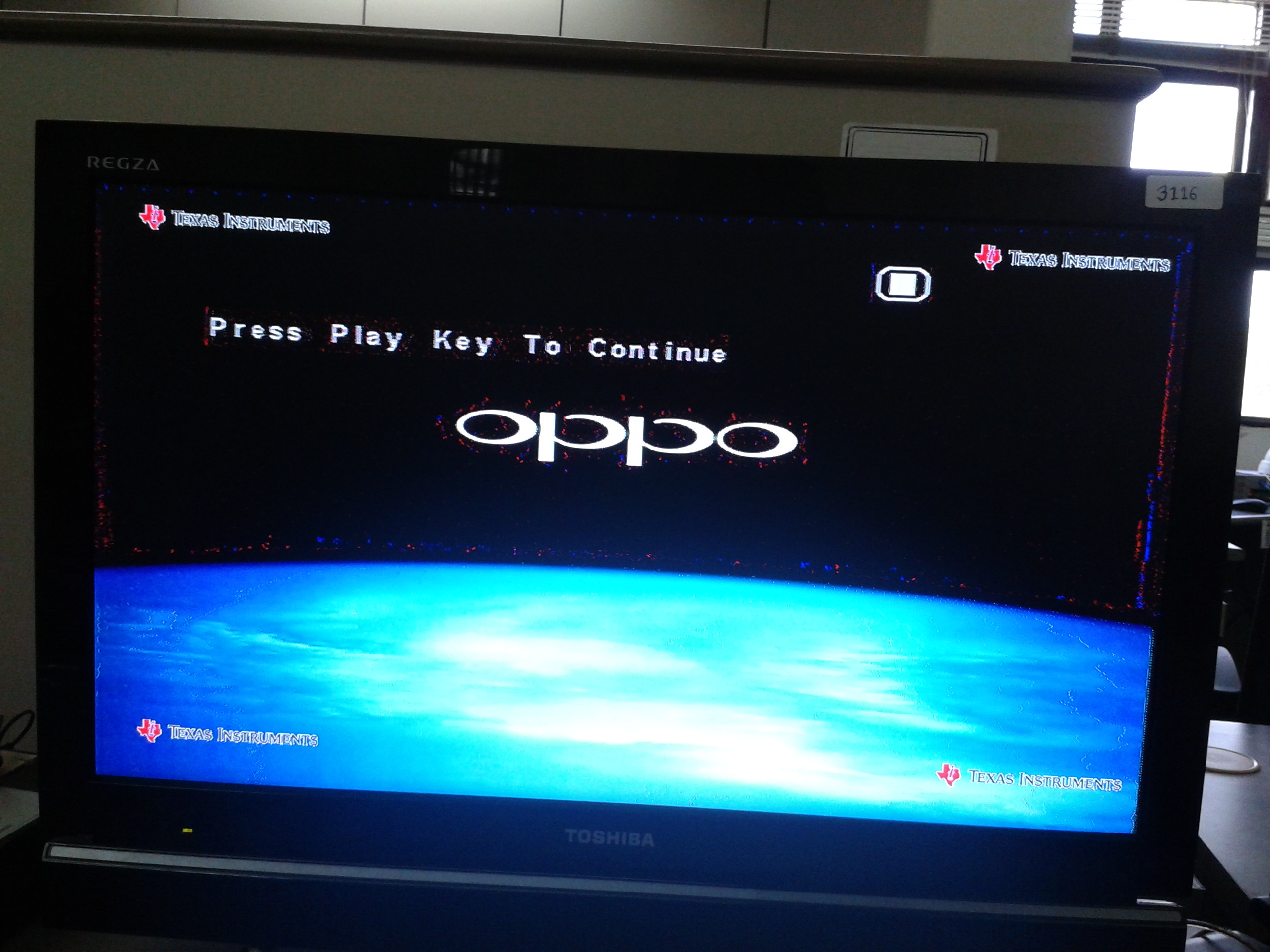

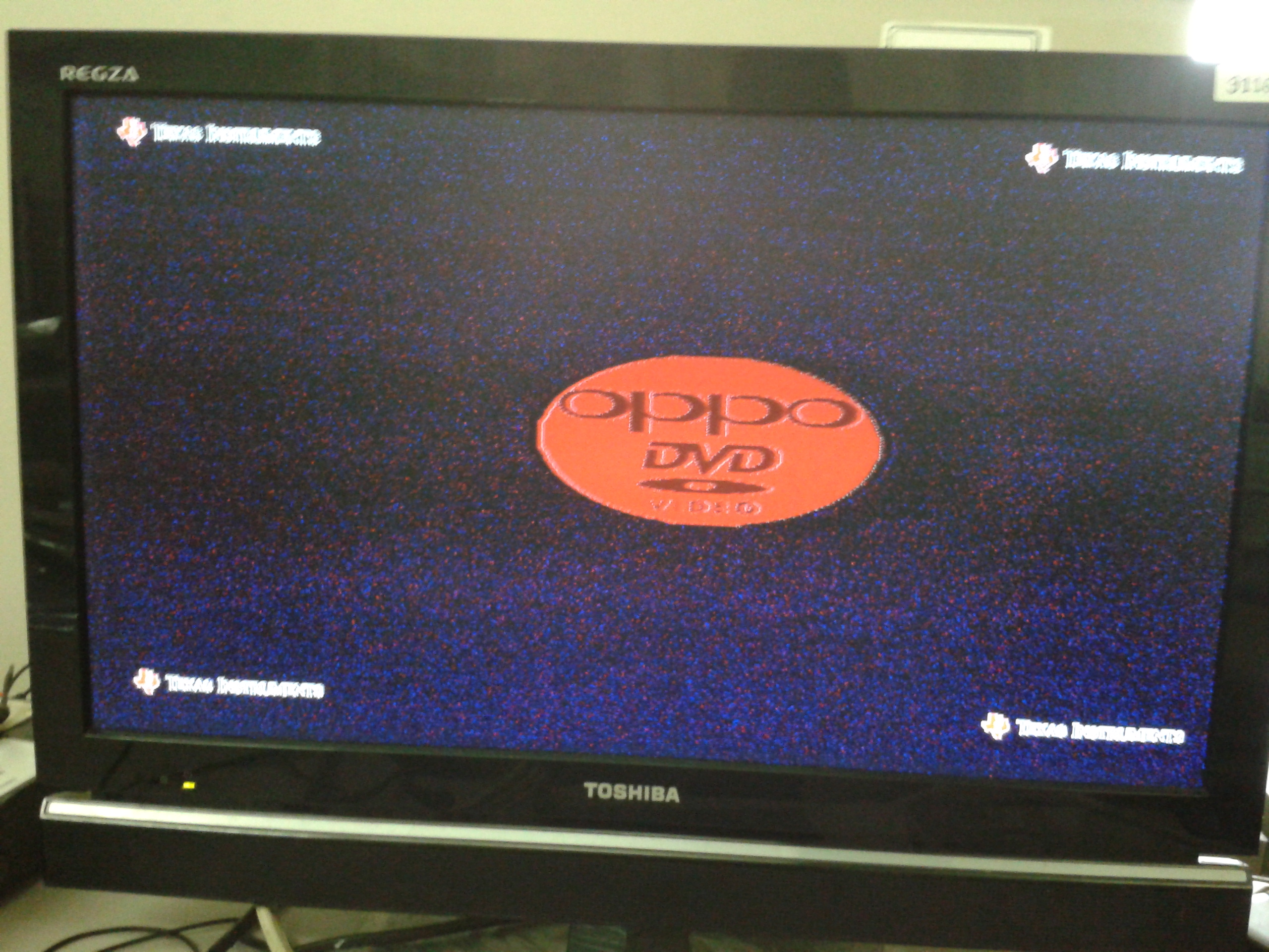

But this application doesn't display captured output properly. There is lots of distortion present in the output.
I am attaching the result of this application.
You can see in this image that there is lots of noise in the video.
I have doubts in the rdk application or framework or in configuring tvp7002 through i2c.
Is there anything wrong with the above capture create time parameters ?

  • Hi Shabbir,
    Can you dump a frame from the capture and see if it is from capture?
    Brijesh Jadav
  • Hi Brijesh,
    Yes It is from capture. I have dumped captured YUV frame and verified. It is as per my very first post.I can't able to attached as its a large file.
