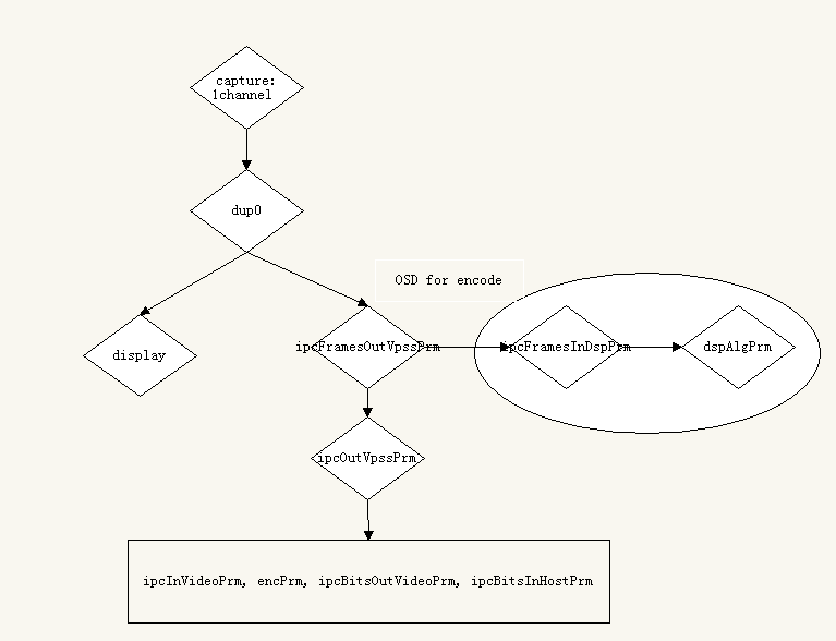

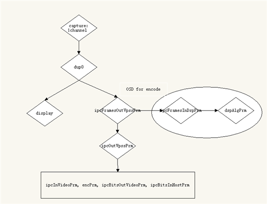

hi,
i'm do a test of 1 channel display&encode.
the 1channel data from tvp7002, and use dup2 for the 2 branch,
one for display, another for encode.
but after add the osd alg, osd content also show on diplay and encode stream.
i itented it only show on encode stram.
in the src_bios6 source code, the dup link only add one reference of the frame?
thanks.
  • Yes the dupLink does not create copies of the frames.Only the frameinfo is copied and sent to two links. This means the buffer should be treated as readonly because if one link changes the buffer it will get modified for both the links.
    RDK 4.0 supports a feature in the dupLink whereby if one of the next link of dupLink modifies the content, the dupLink can be configured such that  modifying the buffer does not affect the other link which would resolve the issue you are seeing.
  • hi, badri, thanks for your reply.
    RDK 4.0 will release date is?
    and RDK 3.5 have any way to solve the problem?
  • RDK 4.0 will be available next week.It is not possible to resolve the issue on RDK 3.5.Attached is a patch which you can try and check if it resolves the issue.if it doesnt solve the issue you will have to migrate to RDK 4.0.
    You will have to invoke the code after creating the dupLink:
    static
    Void duplink_configure_delay(UInt32 dupId,UInt32 delayOutQueId)
        DupLink_DelayParams delayPrms;
        Int32 status;
        delayPrms.outQueId = delayOutQueId; //IN YOUR CASE THIS WILL BE THE ipcFramesOut output queue out of dupLink
        status =
        System_linkControl(dupId,                             DUP_LINK_CMD_SET_DELAY_OUTPUT_QUE_PARAMS,
                           &delayPrms,
                           sizeof(delayPrms),
                           TRUE);
        OSA_assert(status == 0);
