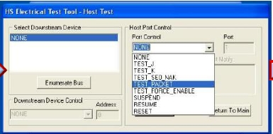

With AM3358, user want to run the "HS Electrical Test Tool" for AM335x's USB test.
Is it possible to do the USB EHCI Electrical Testing with AM335x?
If possible, how can do the test?
(HS Electrical Test Tool)

Thank you.
Then, does AM335x support the Electrical Testings of TEST_J, TEST_K, TEST_SEO_NAK, TEST_PACKET, ... ?
How can user do with the USB port of AM335x?

Before, we checked that "TEST_PACKET" was implemented with the USB driver.
Then, how about TEST_SE0_NAK, TEST_J, TEST_K ?

Take a look at the information in the following link to see if this helps with your question.
Paul
