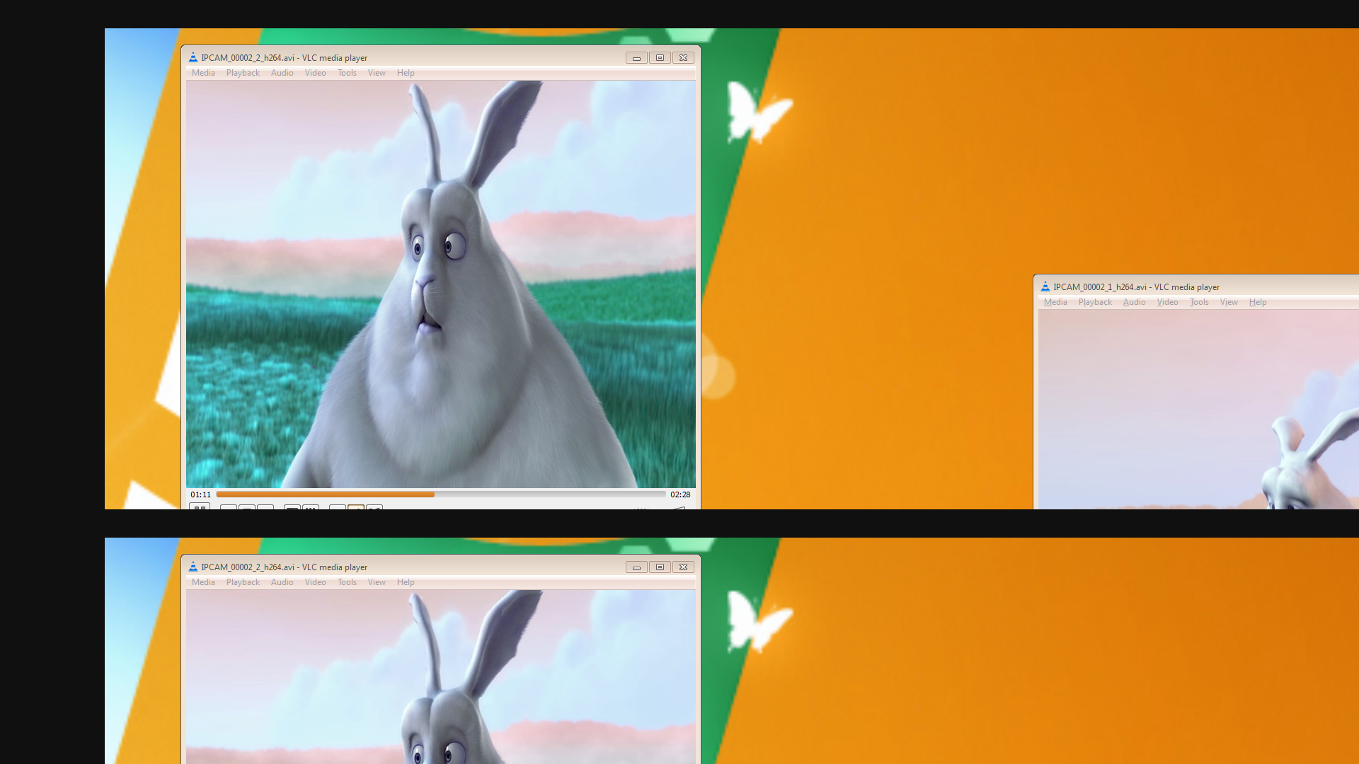

I am using a custmo Dm814x board and can capture using V4L2.  My input is a 1920x1080p60 24-bit RGB source with discrete syncs.  I capture the image below which is ok for 720 lines and then possibly then start of the next frame has been DMA'd into my buffer.
I've checked and the VIDIOC_G_FMT ioctl is returning the correct data, the capture is setup for a 1920x1080 buffer.  It looks to me like the VIP is limited to capture 720 lines?
Does anybody know where a value for this may be defined?  I'm guessing it's in the VIP Port Config but there doesn't seem to be a limit on the number of lines to capture?

  • Sorry, here's my captured image, it's a 24-bit, the R and B values are flipped (another issue but not related to the capture).

  • This issue was caused by using the saLoopback sample.  The capture buffers were 1920x1080 24-bit RGB, the display buffers were 1920x1080 16-bit YUYV so when the capture buffer ptr was replaced by the newly dequeued display buffer ptr the offsets though the mapped fb memory were wrong.  Offsetting the display buffer ptr to align with the base for the capture buffer ptr solve the issue.
