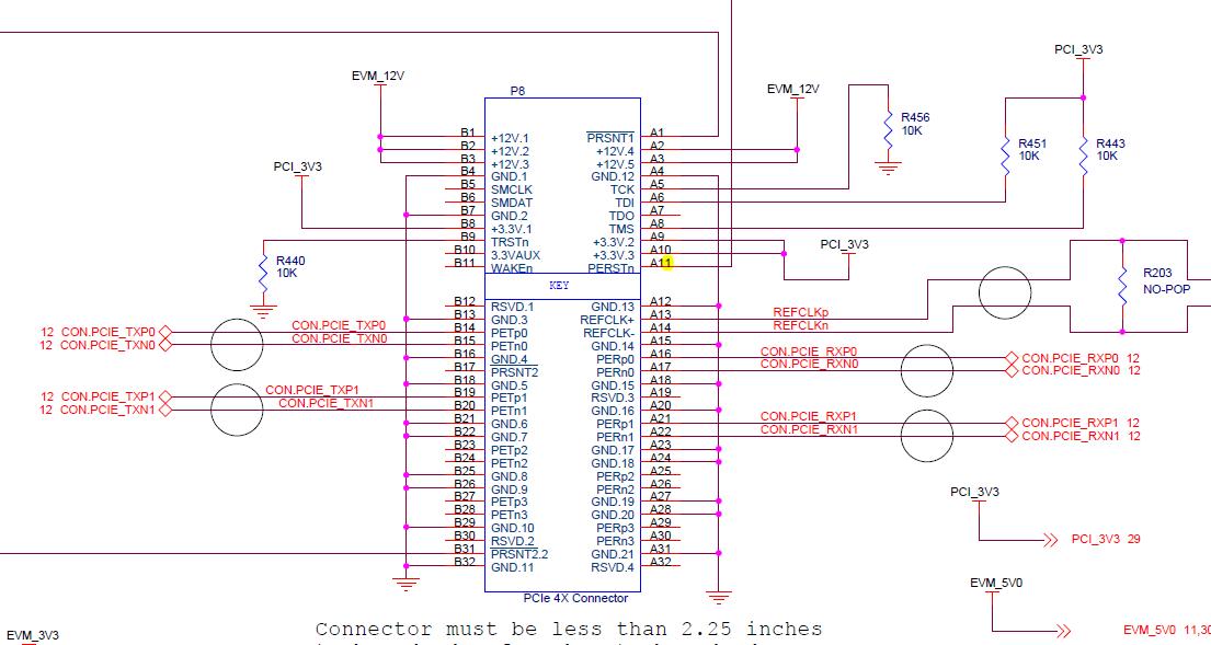

I found the pcie interface can't work normally now, which can't detect the device(RTL8111C) nic which works well in other board).
SW5-1 (PCIe RST) switch was set to OFF.(near PCIE SLOT)
when power on ,there is nothing output from the serial port.
But when I unplug RTL8111C,then power on,the board works normally.
  • Hi Alvin,
    Are you using EZSDK 5.05.02.00? Could you provide full log.
    Pavel
  • Thanks for your reply,I'm now using ezsdk_dm816x-evm_5_04_00_11.
    I give B10 a 3.3V power,and then evm8168 start-up, drive the equipment RTL8111C,but the NIC device don't work.

    ti81xx_pcie: Invoking PCI BIOS...
    ti81xx_pcie: Setting up Host Controller...
    ti81xx_pcie: Register base mapped @0xd7020000
    ti81xx_pcie: MSI info not available, disabled
    ti81xx_pcie: Starting PCI scan...

    ti81xx_pcie_ep: No TI81xx PCIe EP [0xb800] found
    ti81xx_pcie_ep: No TI81xx PCIe EP [0xb801] found
    ti81xx_pcie_ep: No TI81xx PCIe EP found.

  • Alvin,
    alvin lu said:
    I use the DM8168 PCIE as End Point
    Per my understanding, to use RTL8111C or BCM5751 with DM8168 PCIe, you should have the following configuration:
    DM8168 PCIe RC <-> BCM5771 EP
    As you are using the DM8168 PCIe in EP mode (not in RC mode), can this be the root cause for the issue?
    Pavel
