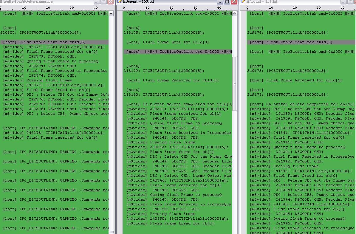

    - I print the received command and log as attach. Could you help to check where I can print more messages?
  • I found the difference as below. did you have further idea that I can print more messages?
    warning messages case is in left, others are successful case...
  • hi badri-SuperMan
    by my checking, the function was stuck here. did you know which function(OSA_...) is for sending messages to be received by OSA_tskWaitMsg()?
