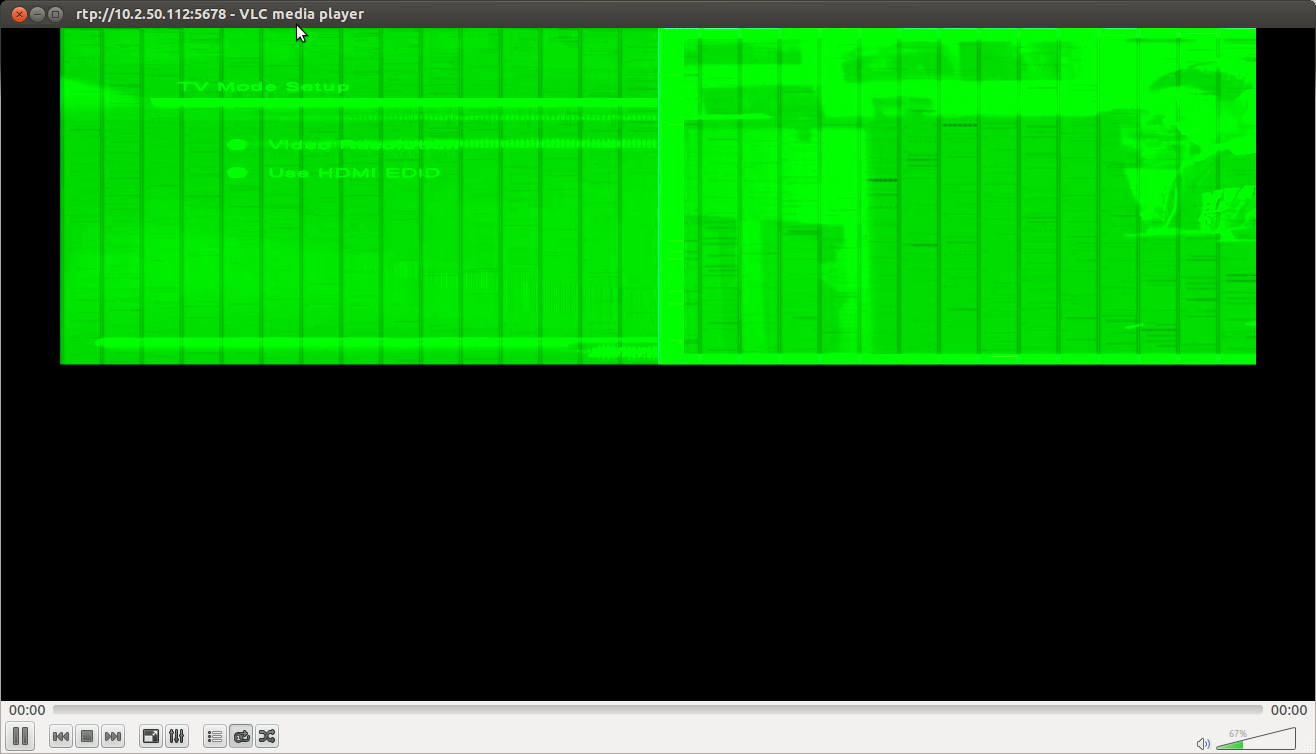

I would like to switch captureLink and nullSrcLink dynamically with selectLink into swMs. (capture 2 HD channels and create 2 nullSrc channels.) However, the selectLink can't select nullSrc correctly. (I got green video, frozen video, ...)
I could use selectLink to switch capture source by setting selectPrm.outQueChInfo[0].inChNum[], but it is failed if setting inChNum[] to nullSrc channels... (I am using RDK 3.0.)
Could you give me some clues to solve this problem? Thank you very much in advance.

  • NullSrc data format of pChInfo->dataFormat = SYSTEM_DF_YUV422SP_UV is not supported in swms.Data format should be SYSTEM_DF_YUV422I

    Besides, I'm trying to get/set selectLink setting dynamically via System_linkControl(). I could not get correct outQueChInfo with SELECT_LINK_CMD_GET_OUT_QUE_CH_INFO and I am not sure if my SELECT_LINK_CMD_SET_OUT_QUE_CH_INFO code is correct. Could you help confirm my code? (Sorry, I don't find the sample code in DVR_RDK.)

    We used DVR RDK 4.0 to try to dynamically switch capture and nullSrc with select link, but still got incorrect result.
    We could start link/chain by selecting nullSrc (ch2 and ch3). And then, we called select link with SELECT_LINK_CMD_SET_OUT_QUE_CH_INFO, saw swMs' input change message, and got below "green" image. Is there any incorrect data format setting of nullSrc (or capture link)?
    Note.
    1) If we select capture (ch0 and ch1) in link/chain creating, and then switch to nullSrc in run-time. We got swMs link's assertion.
    2) SYSTEM_DF_YUV422I_YUYV doesn't work, while SYSTEM_DF_YUV422SP_UV works (in link/chain creation). It doesn't seem to match your suggestion...?

  • NullSrc data format should be SYSTEM_DF_YUV422I_YUYV. Setting it to SYSTEM_DF_YUV422SP_UV is wrong.
    Check if modifying NullSrc to set rtChannelInfo.isDataTypeChanged to TRUE resolves the SwMs assert.
    After change to SYSTEM_DF_YUV422I_YUYV, the chain/link creation hangs up with below message.
    I can't find rtChannelInfo.isDataTypeChanged. Is this variable in swMs or nullSrc?

  • You are setting wrong pitch in NullSrc:
    pChInfo->pitch[0] = SystemUtils_align(pChInfo->width+pChInfo->startX, SYSTEM_BUFFER_ALIGNMENT); pChInfo->pitch[1] = pChInfo->pitch[0];
    For YUV422I dataFormat pitch should be 1920 x 2 = 3840
