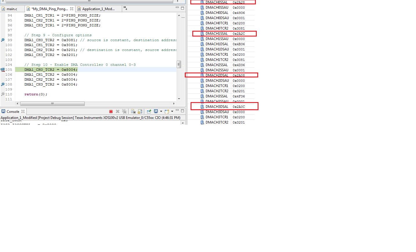

Problem/Possible Bug: DMA source and destination addresses are changed when DMA is enabled.
I am using the C5535 with CCS v4 to use the DMA controller 1 in ping pong mode with I2S channel 2. I am seeing something strange:
When I assign values to the DMACHnSSAL/U, DMACHnDSAL/U (source and destination registers for the DMA controller 1 channels 0-3) the values are stored correctly.
However writing a 1 to the EN (enable) bit in the TCR2 register for DMA1, causes all the values that I wrote in all of the source and destination registers to be incremented by 0x0200.
I see no reason why this should happen. Can anyone tell me why this is happening, and how to fix it? See my pictures below for clarification:

  • I think this is the issue, when you are writing the enable bit, you have changed the source and destinations modes to auto increment and the dma starts running, so the source and destination address will change as you have observed.  You need to maintain your desired src dst modes when you write to TCR2 in the enable step.

    Thanks for the response Shawn. I don't think this is the issue. From the technical reference for initializing the DMA steps 9-11 (the last steps):
    9. Configure DMACHmTCR2 accordingly. Through this register you can specify the source and destination addressing modes and burst mode. You can also enable automatic reload, event synchronization, CPU interrupts and Ping-Pong mode. Note that you must keep EN = 0 and SYNCMODE = 0 during this step.
    10. If the DMA channel is servicing a peripheral, ensure that the corresponding peripheral is not active and hence not generating synchronization events.
    11. Enable the DMA channel by setting EN = 1 (and SYNCMODE = 1 if using synchronization events).
    As you can see the last step (step 11) just says to enable the EN bit and SYNCMODE bit. Setting the source and destination addressing mode bits (DSTAMODE/SRAMODE) happens in step 9.
    I recognize that you are suggesting that I set the DSTAMODE/SRAMODE bits in TCR2 as the last step in the initialization process for the DMA, but you can see from the technical reference that it is advised to only set the EN and SYNCMODE bits as the last step in the DMA initialization process. That is what I am doing, but the contents of the address registers changes.
    Also, when I set the EN and SYNCMODE bits in TCR2 as step 11- if what you say is true - all of the contents of the source and destination address registers should continuously increment (because I left the DSTAMODE/SRAMODE bits as 0 in my step 11) -  but they don't. They simply get incremented by 0x0200 when the EN bit is set, and remain that way.
    I will try what you are implying,  and I will try to set the DSTAMODE/SRAMODE while I also set the EN and SYNCMODE bits, and I will report my findings. I do not expect this to work however, and if it does, then the technical reference  has a serious error within it.

  • I just checked the CSL in the DMA_start( ) function, when it starts the DMA it does the following:
    hDMA->dmaRegs->DMACH0TCR2 |= CSL_DMA_DMATCR2_DMASTART_SYNC_MASK;
    the above equates to DMA1_CH0_TCR2 |= 0x8004;
    So i think the key thing is that when you enable the DMAs you need to use a |= (OR equals) not a straight =

  • Update:
    Shawn - your suggested fix did indeed work. I see in your second post now why that is!! Ill have to go back and and carefully check whether I am using = or |= for my register assignments!!! tricky!
