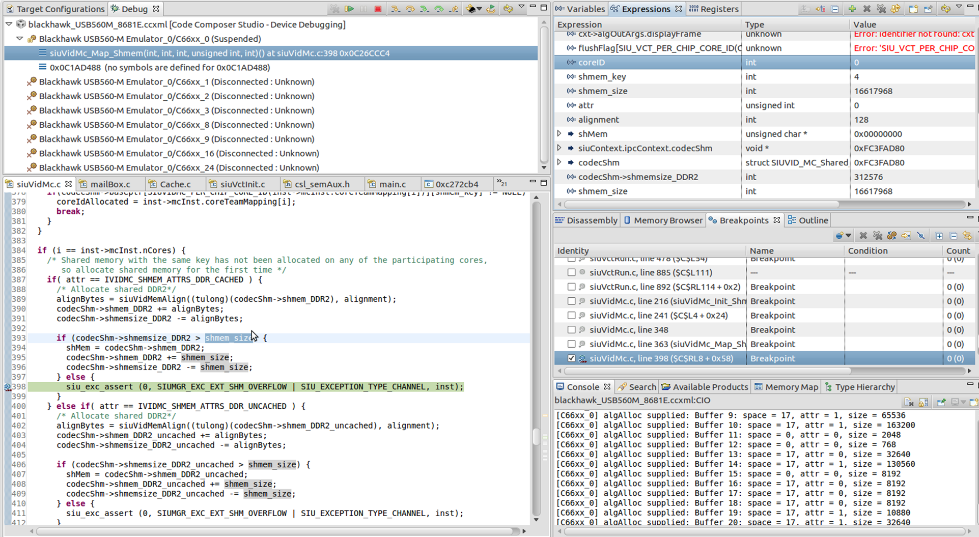

    I have used JTAG to trace DSP while running MCSDK Video PCIE demo.
    When I run demoSave2File.sh second time without reset and re-download dsp image, DSP can receive and try to create the new task.
    But it will be failed when assign resource.
    CCS log:
    [C66xx_0] Algorithm Instance Creation Done @ core 0...
    [C66xx_0] Assign Resource Failed for core 0.. Exiting
    Why assign resources will be failed when executing the second task and how to fix it?
    Harvey

    If your application calls xdm2p0_vid_enc_create() every time when running the encoding, the shared memory buffers are reset in siuVidMc_Init_ShmemTab(). In that case, the problem you saw should not be related to the issue with siuVidMc_Map_Shmem() and siuVidMc_Unmap_Shmem(). Please verify this by setting breakpoint in siuVidMc_Unmap_Shmem() and stepping into it to see if the exception happens from there.
    When the exception happens, can you please check CCS-ROV for possible errors? What is B3 in the exception log?
    Hongmei
  • Hi Hongmei,
    Yes, my application calls xdm2p0_vid_enc_create() every time when running the encoding task.
    The breakpoint in siuVidMc_Unmap_Shmem() is never hit, the exception happens in siuVidMc_Map_Shmem():
          if (codecShm->shmemsize_DDR2_uncached > shmem_size) {
            shMem = codecShm->shmem_DDR2_uncached;
            codecShm->shmem_DDR2_uncached += shmem_size;
            codecShm->shmemsize_DDR2_uncached -= shmem_size;
          } else {
    ->        siu_exc_assert (0, SIUMGR_EXC_EXT_SHM_OVERFLOW | SIU_EXCEPTION_TYPE_CHANNEL, inst);
    When the exception happens, codecShm->shmemsize_DDR2_uncached = 312576 and shmem_size = 16617968, so it get into the else case.
    My test case is use the demoSave2File.sh script of pcie_h264hpenc_demo and assign to single core 0, the issue will occur while running third time.
    Thank you,
    Harvey

  • Hi Hongmei,
    1) You are right, I copied the incorrect code segment, The exception happens in CACHED DDR case. You can check the attached snapshot again.
    2) When first time siuVidMc_Init_ShmemTab() is called, codecShm->shmem_DDR2 and codecShm->shmemsize_DDR2 can be init by the code:
      if ( codecShm->shmem_DDR2 == NULL ) {
        codecShm->shmem_DDR2      = codecShmHandle->extShm;
        codecShm->shmemsize_DDR2  = codecShmHandle->extShmSize;
    But after first init, codecShm->shmem_DDR2 is set as non-null value, so codecShm->shmem_DDR2 and codecShm->shmemsize_DDR2 won't be reset anymore.
    codecShm->shmemsize_DDR2 will be getting lower after siuVidMc_Map_Shmem() is triggered, until codecShm->shmemsize_DDR2 < shmem_size and get into exception.
    Can I remove the if conditions in siuVidMc_Init_ShmemTab()?
    //  if ( codecShm->shmem_SL2 == NULL )
    //  if ( codecShm->shmem_DDR2 == NULL )
    //  if ( codecShm->shmem_DDR2_uncached == NULL)
    Should I use any other method to reset codecShm->shmem_DDR2 ... ?
    Thank you,
    Harvey
  • Hi Harvey,
    Thanks for the confirmation. From what you provided, it looks like you are using the multi-channel patch release on top of MCSDK Video 2.1.0.8. The if  NULL checks were added for supporting multiple channels on C6678.
    If your testing/application is for single channel only, you can remove the if checks. With that, you should be able to run the encoding many times.
    When multi-channel is needed, you can try resetting "codecShm->shmem_SL2", "codecShm->shmem_DDR2", and "codecShm->shmem_DDR2_uncached" in xdm2p0_vid_enc_delete() after calling ALG_delete(), assuming that all the channels have completed the encoding by that time.
    We mentioned earlier that the H264HP encoder is not calling siuVidMc_Unmap_Shmem() to free shared buffers. This will be fixed in the next release of H264HP encoder. With that fix and appropriate changes in siuVidMc_Map_Shmem() and siuVidMc_Unmap_Shmem(),  we will have a cleaner way to handle alloc-free-realloc of shared buffers. For now, please try the workarounds above.
    Hongmei

  • Hi Hongmei,
    Thanks for your help.
    The breakpoint in siuVidMc_Unmap_Shmem() can be hit after updating the new H264HP encoder.

  • Hi Hongmei,
    It works after defining related symbols in dsp\ggcfg\build\hdg\sv04\ggvf0.becmd.
    Harvey
