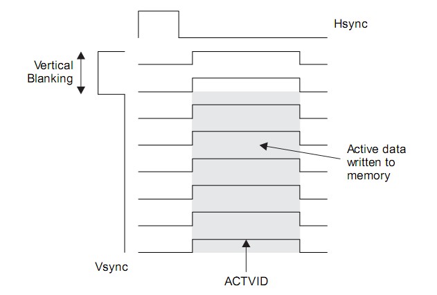

  • thanks for your advise, i have read some before,
    when i capture discrete data with fpga on vip0, it cannot work properly ,so i think if the sinal have problem or not
    i have modify signal follow "The VIP port requires that the ACTVID signal is active for all lines of the incoming data, including the vertical blanking region. The vertical blanking region, itself, is not written to memory", but when i start capture , vip say "V4L2_BUF_FLAG_ERROR present!!! Port a overflowed"
    so i want to know if vip have some other important points about sinal timing?

  • Are you making sure of toggling ACTVID signal on all lines including blanking lines? On 1.1 silicon revision, it will not work otherwise. Also you should use ACTVID style of capture.
    Brijesh
  • yes, i has check the signal of VSYNC/HSYNC/ACTIVD,and follow Docment "TMS320DM816x DaVinci Video Processors Silicon Errata (Rev. 2.1, 2.0, 1.1, & 1.0) (Rev. D).PDF", when VSYNC is high means vertical blanking region, at this time also have HSYNC and ACTIVD? when HSYNC is low and ACTIVD is high means data is active, now i can capture only 18 byte one frame or appear "Port a overflowed"
  • Hi Wen,
    VSYNC not necessarily mean vertical blanking area, is it the case in your decoder? Yes, you will have to toggle ACTVID signal during this signal as well. Are you using any other modules in the VIP path like scalar? Also is your output format YUV420? If it is, please note it could cause overflow when it receives odd number of lines?
    Brijesh

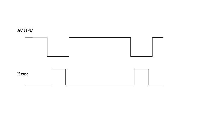

          input RGB data are given by fpga to vin0, in capture app 'saLoopBackFbdev.c", we set capt.fmt.fmt.pix.pixelformat to V4L2_PIX_FMT_YUYV, I think i did not use other modules,our output format is YUV422, input format is RGB888,as i said, only capture 18byte every frame and frame rate is too big or recieve overflow,so what i should check ?
  • Hi Wen,
    Could you explain your input signals? which pins are connected? which input signals you are using? Have you configured VIP accordingly?
    Brijesh Jadav
  • 1. my input signals is 1920*1080@60p RGB24 data given by our fpga
    2.the jpeg file is our  connectedadd  signal pin
    3.follow is pin mux in /arch/arm/mach-omap2/device.c

  • Hi Wen,
    Can you check if your ACTVID and Hsync polarity is matching with the configuration? Also can you try inverting pixel clock polarity?
    Brijesh Jadav
  • yes, i has check the ACTVID and Hsync polarity, they are right ,ACTIVD is high active,Hsync is low active

  • Hi wen,
    From the register configuration,
    hsync polariyt is active low
    vsync polarity is active low
    actvid polarity is active high
    pixel clock is set to rising edge
    Could you please check if configuration is correct?
    Brijesh Jadav
  • hi Brijesh
    yes  when pixel clock polarity is set to be VPS_VIP_PIX_CLK_EDGE_POL_FALLING or VPS_VIP_PIX_CLK_EDGE_POL_RISING,the result is same

  • Wen,
    I still think there is some signalling issue. Can you again check that if vsync is active high or low?
    Brijesh
  • thanks,
    I has try  work on EZSDK5.05 yesterday, but also fail! so i think it is  silicon version1.1 issue or signalling issue but not m3 binary
    I check vsync it is do active low as hsync active low,  and when vsync is low or high, the activd and hvsyn also signal,
    Because if i start signal, the app will wrong, this said 8168 can find signal,but however it cannot clearly distinguish
    Do you said tvp7002 has be test ok with discrete sync on silicon 1.1? I check 7002 docment, it's hsync_out and data_out has some delaytime to hsync_in ,but no said some vsync timting,can you give me a 7002 signal timing in order i can follow,
