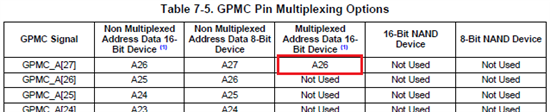

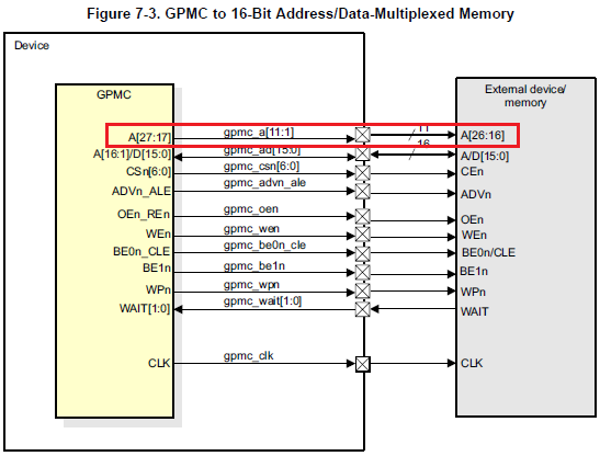

Hello, I have a question on AM335x TRM(spruh73h).
 - The A26 is assigned to GPMC_A[27] on "Multiplexed Address Data 16-Bit Device" on Table 7-5(P255).
 - On the other hand,    it seems that the A26 is assigned to GPMC_A[11] on Figure 7-3(P258).
Which description is correct?
The A26 was assigned to GPMC_A[11] on previous TRM(spruh73g).
