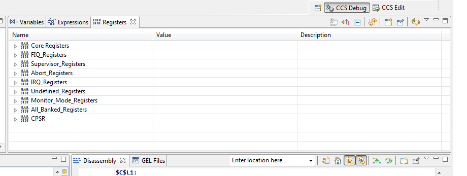

    By the way, it seems that I cannot access the register in the debugger memory window:
    Any help is welcome.

  • It was probably because of clocks. I will come here and give my feedback on monday, since I don't have time now.
    Thanks.
  • It was definitely the lack of clock which was the problem. I discovered that there is this spiInit(); function in the am335x_indcomm_startup.c. So basically, my test script is now:
