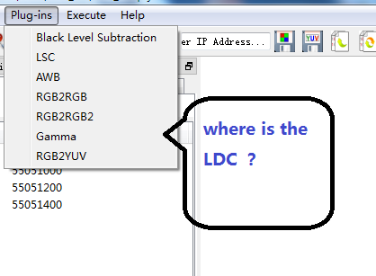

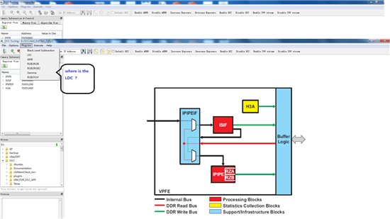

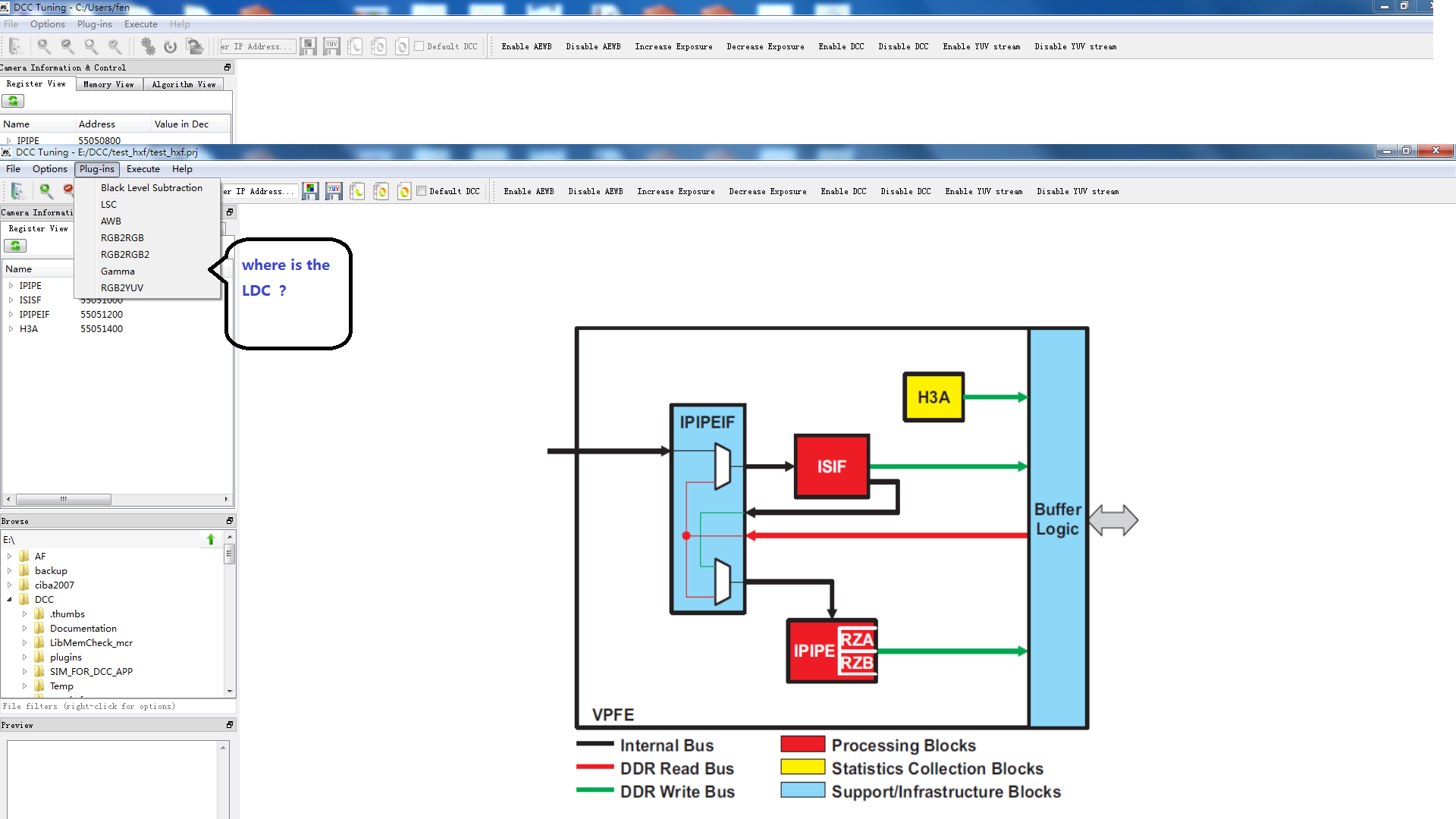

where is the menu to start the LDC module? I can't find it , would you please show me?
Are you using full version of the tuning tool? or light version?
if you dont have full version please get in touch with your local FAE for the access.
Uday
Hi Xiao Feng Huang,
You can find this option in plug-ins. VNF(NSF2 + TNF + LDC)

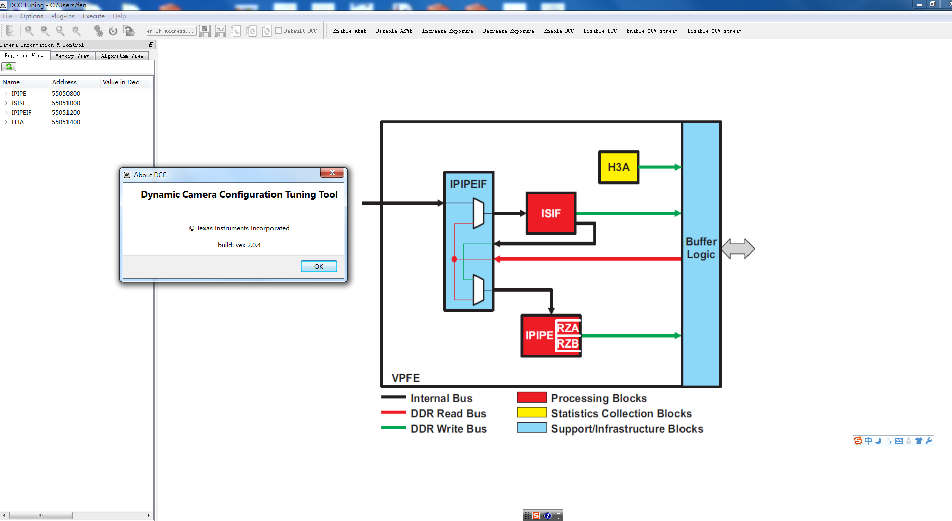

Hi Uday,
Where I can find the version details ?
In release notes they mentioned like this... * DCC - Dynamic Camera Configuration Tool Release - GA 1.0 * and build version is 2.0.4.
Gajanan
you are using lite version of the tuning tool. that is the reason why you dont have LDC in the tuning tool.
Please contact local FAE to get access to full version.
