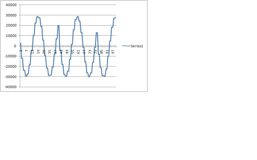

Hello!
I am working with TMS320C5515 EVM under CCSv5.3.
I would want to know how can I change the sampling Frequency of AIC3204. I was developing a program and I thought that It was configured to 48KHz sampling Frequency. However, when entering with a 1KHZ tone input, in the output I get a signal that would be of 1 Khz If the sampling frequency was 24KHz. not 48KHz.
I want to know If I have the sampling frequency of the aic3204 bad configured, or If there are another problem different by that one.
I put the configuration here:

  • Since you are configuring codec as slave (Register 27 clock settings), sampling frequency depends on the clocks generated by I2S. What is the CPU clock and I2S clock divider values you are configuring?. Or are you intended to configure codec as master?.

    I may think that is master configured?
  • After that in a loop, it is done the next:

    This is a loop where the input of Stereo Input 1 is looped to Headphones output.
    However, When I put a 1KHz signal at the input, I get the next at the output:
    Then, if it well configured at 48KHz sampling, I don't know why there is not a period each 48 samples since the input is a sine at 1KHz.
  • The settings you have shown match settings I have used with CPU as master and CPU clock at 100Mhz.  Are you running the CPU at 100Mhz?
    Also, try a run without the fprintf( ) statement in your C code, that printf( ) will slow down your entire for loop, it is possible your just missing data.
    -S

  • I also thought about fprintf commmand is affecting the code. If this would be the case, which command should I use to store the sample in an extern file?
  • Try saving the input samples in an Array and run the for loop for a set number of times & when the for loop is finished, use the memory view and "store to file" to store the values to a file.
  • It was the fprintf command. I ran it without this command and it works fine. To store the samples, I save it in a buffer declared as global and then I did the loop for fprintf in main function.

        AIC3204_rset( 60, 0x0f );      // MIC_PGA_R unmute
        AIC3204_rset(  0, 0x00 );      // Select page 0
        AIC3204_rset( 81, 0xc0 );      // Powerup Left and Right ADC
        AIC3204_rset( 82, 0x00 );      // Unmute Left and Right ADC
        EVM5515_wait( 200 );  // Wait
        /* I2S settings */
        I2S2_SRGR = 0x0015;
        I2S2_ICMR = 0x0028;    // Enable interrupts
        I2S2_CR   = 0x8012;    // 16-bit word, Master, enable I2C
        /* Play Tone */
        for ( i = 0 ; i < 5 ; i++ )
            for ( j = 0 ; j < 1000 ; j++ )
                for ( sample = 0 ; sample < 48 ; sample++ )
    /* Read Digital audio input */
    while((Rcv & I2S2_IR) == 0);   // Wait for receive interrupt to be pending
                    data3 = I2S2_W0_MSW_R;  // 16 bit left channel received audio data
                  data4 = I2S2_W1_MSW_R;  // 16 bit right channel received audio data
    /* Write Digital audio input */
                    while((Xmit & I2S2_IR) == 0);  // Wait for receive interrupt to be pending
                  I2S2_W0_MSW_W = data3;  // 16 bit left channel transmit audio data
                  I2S2_W1_MSW_W = data4;  // 16 bit right channel transmit audio data
        /* Disble I2S */
        I2S0_CR = 0x00;
        return 0;
