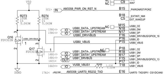

  • Hi, thanks for your suggestions.  I have pasted the part of our schematic below for the USB signals coming from the processor;  I believe it has been implemented as per the guidance you and Bin gave.  One thing which I should have mentioned earlier, is that we have a USB hub connected to USB0 controller, so I don't know if this would need to be catered for differently.
  • This schematic will work fine if you have an on-board self-powered USB device attached. Is your hub on-board?
  • The Hub is indeed on the same board, using Cypress CY7C65632-48AXCT hub chip.
  • Can you see USB0_DRVVBUS going active? Can you check the voltage at USB0_VBUS? It should be above 4.4V.

  • I think Biser may have a valid point with respect to VBUS voltage.  The USB OTG specification requires the AM335x VBUS input impedance to be 40k - 100k ohms so the 100k ohm resistor R273 may be too large to get a voltage above the VBUS valid threshold.

    We have looked at the two signals, USB0_DRVVBUS and USB0_VBUS and noted the following:
    • USB0_DRVVBUS => shows a 100ms low to high pulse of 3.3V
    • USB0_VBUS => shows a 100ms low to high pulse of approx 2.3V (which is much lower than required)
    As per your comment Paul we will look into the resistor and see about changing it to a lower one.
    John
  • Here is some additional info from the resistor changes we did:
    Changed R273 to be 56K instead of 100K: USB0_VBUS pulsed at approx 2.8V for 100 ms; so this was an increase but not as much as we would expect.
    Changed R273 to be be a 5K instead this time: USB0_VBUS went to approx 4.5V and stayed there, i.e. there was no pulse this time.
    So the USB0_VBUS looks better, but 'usb start' in u-boot still results in the timeout I mentioned before, with it timing out waiting for Host Mode (bit 2) of DEVCTL register still to be set.
