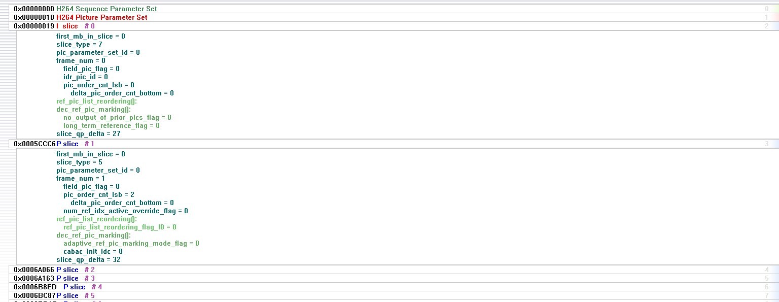

  • Can you provide more info about the issue. What do you mean by encoder is 30 fps ? Where are you measuring this fps. Pls share the logs of Vsys_printDetailedStatistics.If you are using Chains then you will have to implement equivalent function to Vsys_printDetailedStatistics and share the log,
  • HI,Badri.
    Firstly, I create a chain without capture and set encode targetFrameRate with 10 fps.
    Secondly, I save a H264 data file and use  BAOFENG Player to play it.
    Actually, I find that the video frame rate is 30fps, rather than 10fps.Why the targetFrameRate parameter  is not invalid?
    Looking forward to your suggestion,Thanks.

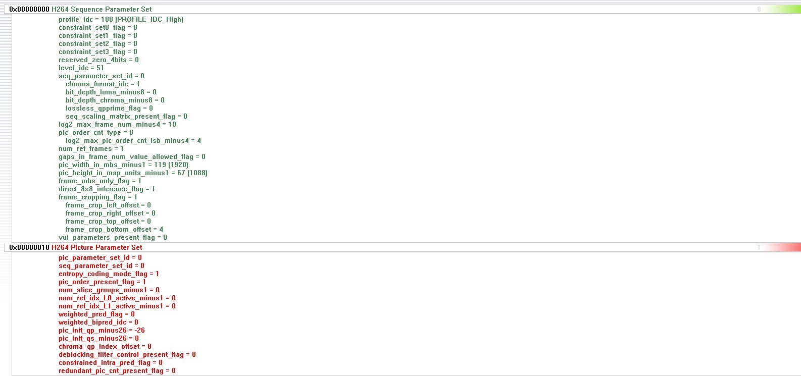

  • - Check if VUI info is present in the encoded stream by checking in a H264 elementary stream analyzer like elecard.
    - Check if you are receiveing frame from encLink at 10 fps or 30 fps by doing System_linkControl (,,,ENC_LINK_CMD_PRINT_STATISTICS) and share the log. Make sure you collect the log 2 times with 60 second interval.
  • The following is elecard log:
    The following is M3 Video Log(2 times):

  • The encoder is correctly outputting frames at 1/3 of input fps. There is some issue with NullSrc configuration which is resulting in 33 fps instead of 30 fps.
    From the stream it looks like VUI info is not present. Without VUI info the player may be assuming some default frame rate and doing playback.
    Make sure you set encPrm.chCreateParams[i].encodingPreset = XDM_USER_DEFINED and check if the VUI info is present in the stream after this.,
    Refer this thread for enabling VUI info : http://e2e.ti.com/support/dsp/davinci_digital_media_processors/f/717/p/237004/830581.aspx#830581
  • haha,that is OK! Thanks a lot,Badri.
