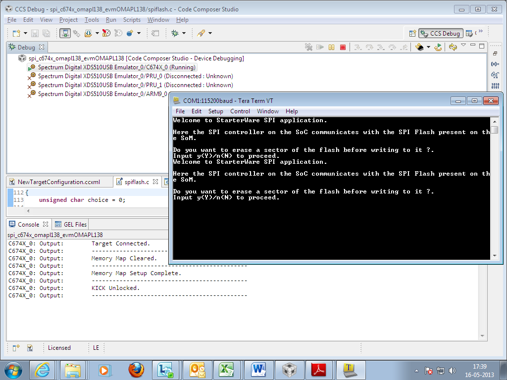

  • Hi Mok,
    Able to successfully run the example, spi_c674x_omapl138_evmOMAPL138  on OMAPL138EVM Zoomkit-LogicPD. Attached the snapshot of it. The text messages displayed in the teraterm inside the snapshot is outputted from the SPI example code.
     The following are my settings for this run:
    1. Boot switch settings: S7[5:8]; Boot mode:- EMU Debug; 8 - ON,7 - OFF,6 - OFF,5 - ON. Emulator: XDS510 USB emulator.
    2. In target configuration file, selected the emulator type as "Spectrum digital XDS510USB Emulator" and the board type as "EXPKITOMAPL138"
    Make sure whether the DDR2 configuration for your customized board is appropriate. you can refer to section 2.13.1 of "TMS320C674x/OMAP-L1x Processor
    DDR2/mDDR Memory Controller User's guide"  http://www.ti.com/lit/ug/sprugj4b/sprugj4b.pdf and check the sequence given under "Initializing Following Device Power Up or Reset"
