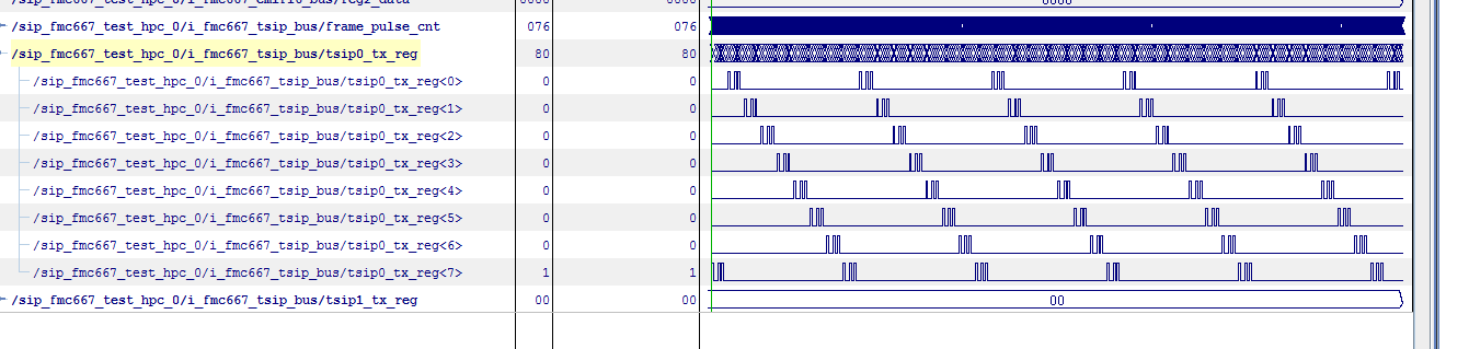

I am currently testing the TSIP on a prototype board with the C6678 DSP. The test I am implementing involves connecting all the TSIP signals to an FPGA and looping the TX data signals from the DSP back onto the RX signals back to the DSP.
The FPGA provides a 16.384MHz clock to each clock pin on the DSP and a Frame Sync signal that pulses from high to low every 2048 clock cycles. The frame sync signal is sent to each FS pin on the DSP.
I run the test project "TSIP_testProject" provided in the C6678 PDK package to test my setup with the following configuration settings:

With these settings, I pass the tests on both TSIP ports on the DSP. However, when I scope the TSIP pins on my hardware, I only have one active link on both the TX and RX lines. I would have thought that there would have been 8 active links when I have a 16.384MHz clock and specified a 8.192 Mbps data rate?
Would there be an issue with my frame sync signal? It specifies in the TSIP user guide (SPRUGY4) that for 8.192 Mbps operation, there are 1024 clocks per frame in single-rate clock mode and 2048 clocks per frame in double-rate clock mode, so I presume it should be fine.
I have specified 256 timeslots per frame and considering that each serial interface link supports 8-bit timeslots, does this mean that it is not necessary to operate the other links?
Am I right in thinking that I need to reduce the number of timeslots per frame? If I do, then should I not also need to reduce the frame sync pulse rate?
Fearghal

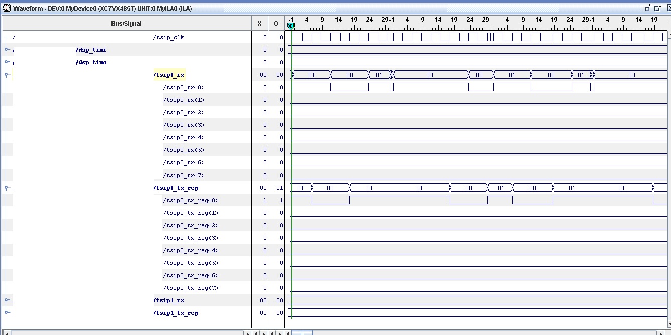

  • Hi Tom,
    I am using double rate clock.
    I can provide an image of data captured using the chipscope tool. I do not have frame sync information in this captured image. Just clock, TX and RX. I will try and update with frame sync included.

    I think my issue is with how I send data and how I initialize the application buffers within the TSIP_testProject. I am not sure if I am only sending enough data so that only TSIP TX0 is required?
    Is that what is expected in the TSIP_testProject?
    I know I should have no issue with the TX1-TX7 and RX1-RX7 links, since I can affect these by changing the idle state of the pins. This would leave me to believe that these pins are just not required due to the setup I have.
    What I am looking to do is confirm that all 8 lanes can send and receive data through the provided TSIP_testProject in the C6678 PDK
    Fearghal

  • I have included a pdf of the requested signal timings captured while running the TSIP test project from TI with the settings I have stated above. Is there anything you can suggest with regards to the software configuration that may help me? Would you know if the original test project was only supposed to have one link tested by default?
    Thanks Tom
    Rgds,
    Fearghal

  • Fearghal,
    Looking at the code, only lane 0 is being requested. If you look in the timeslotConfig function within test.c the first few lines of code setup the port ID and the timeslot ID inside the variable “timeSlotLinkPort”. As defined in test_cfg.h, bit 9-11 of this variable is for link number.
     The following code can be added in order to change which lane you want the data to be transmitted/received from:

  • Dear Dorian,
    I slightly modified our code to map timeslots to given lanes.
    TS0 > Lane 0, TS1 > Lane 1, ..., TS7 > Lane 7, TS8 > Lane 0, TS9 > Lane 1, etc..
    There is some progress as I can see data flowing out on four lanes (0 to 3).
    Then I tried to attach timeslots to Lane 0 to 3, that's fine, data flowing on Lane 0 to 3.
    Then I tried to attach timeslots to Lane 4 to 7, that's fine but data flowing on Lane 0 to 3 and not 4 to 7.
    It is as if out of 3 bits, only 2 lanes bits are used by the driver, can you double check?
    Arnaud
  • Okay, some progress:
    CSL_TSIP_DATARATE_16M had to be changed to CSL_TSIP_DATARATE_8M as per this sentence in the user guide (The maximum number of active serial links is reduced to four and two, respectively, in these configurations)
    So we have data on all the eight lanes :)
