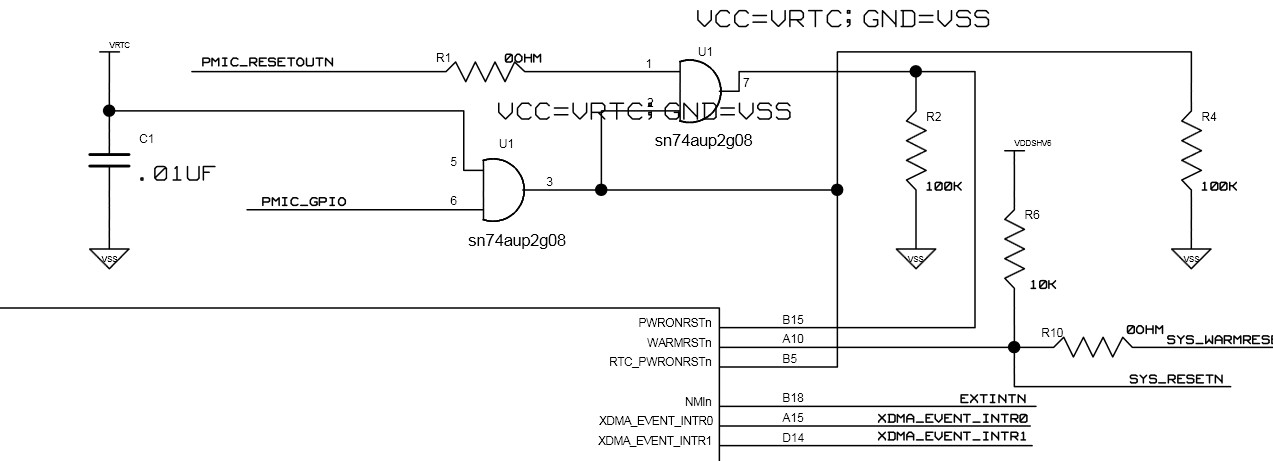

I want to save time, and I used the command date 051410002013.10,hwclock -w,hwclock -s,but it seems not work. Once the board is powered down,the time is lost.I add the "hwclock -s" in rcS,too. My board is similar to the AM335x EVM,and I have a button batteries which seems work well on my board. I use the internal rtc in am3359, if I want to make it work well,how can I do.
  • You mentioned your board design is similar to the EVM.  The EVM does not use a coin cell to power the RTC.  Can you provide a snapshot of your schematic showing the RTC power supply connections.

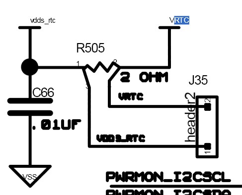

    I also need you to attach a snapshot of the RTC power supply connections, so I can confirm they are connected properly.
    The coin cell battery on the EVM connects to the PMIC to power the RTC in the PMIC.  The RTC in the PMIC is designed to operate from a coin cell battery.  However, the AM335x RTC requires a single regulated 1.8 volt power source if using the internal RTC LDO or two regulated power sources, 1.8 volt and 1.1 volt, if you are not using the the internal RTC LDO.
    Please review the RTC section of AM335x schematic checklist for more details related to RTC connection options.

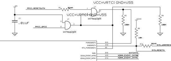

  • Hi peaves,thanks for your reply. There are some snapshots of the RTC power supply connections.

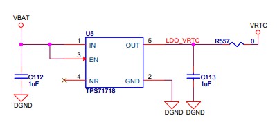

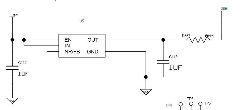

    I see the AM335x EVM on wiki carefully,it seems that VRTC supply the power for rtc:
    And rtc is get from VBAT:
    So it seems that once cut the power,the rtc can not work. I do not know is it right.

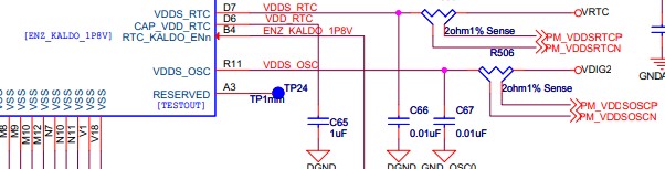

  • I'm looking for an answer to this question as well. Our design uses the TPS650250 PMIC which does not have an internal RTC. The RTC in the AM335x will be relied upon to maintain time when total power is lost to the system. Currently, since there is no need for the RTC-Only mode, the internal RTC LDO is turned off (RTC_KALDO_ENn tied to VDDS_RTC) and the VDD_RTC is powered through the CAP_VDD_RTC pin by the 1.1V supply from the TPS 650250. Provided I'm using silicon v2.0 (Not sure this is even necessary since RTC-Only mode is not used anyway), how can I power the RTC  on the AM335x with a battery when mains power is lost?
