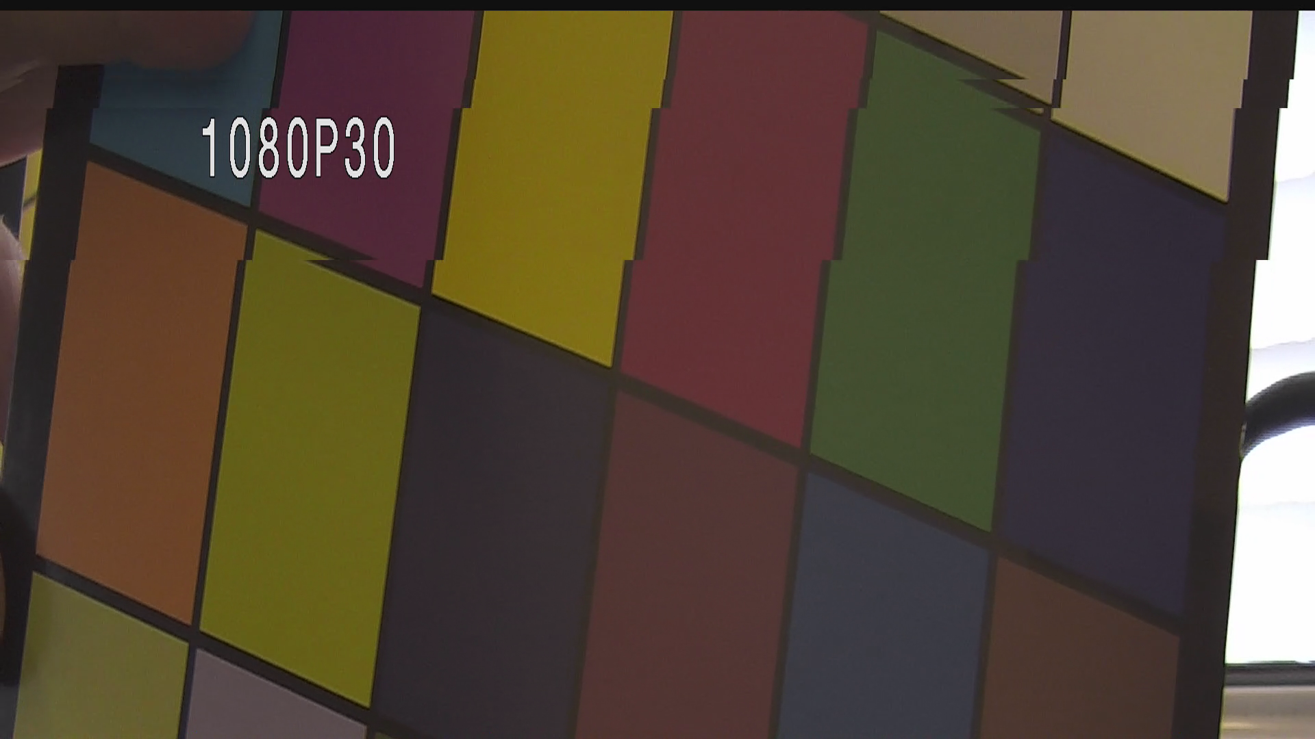

Despite the captured video being correct most of the time (Y/C correct, colours correct, streaming OK) we are getting a couple of glitches which seem to come & go.
Capture is BT1120 YUV input, 720p60 or 1080p30, Appro IPNC MT5 DM368 SDK 4.0.x

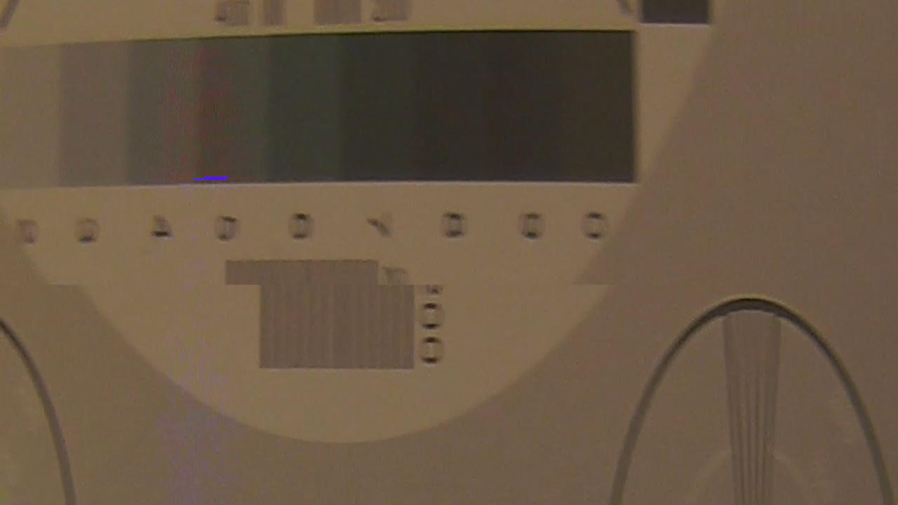

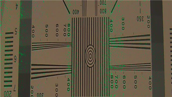

Firs issue is occasional bright green or blue/pink highlights, but not necessarily when the picture is actually bright:
2nd issue is "tearing" of the bottom part of the screen, it seems like the capture/stream sometimes repeats the previous frame(s) or stutters, and does not keep up with movement, causing out-of-sync image (always in the bottom half of the picture) - here you can see the test card has been moved, and the bottom part has not kept up. There is also a small blue/purple artefact visible as mentioned above:
It feels like we're so close to it working 100% correctly, but obviously some small setting is wrong somewhere!
  • The green dots could be issues with setup/hold AC timings between the sensor and the DM365.  Could you try inverting the PCLK either on the sensor, or the processor receive side and see if that helps?  Capture this on a scope to see if you're violating the setup or hold times on the pins of the processor.
    Is the tearing occurring on the decoded image on a PC (after being received over ethernet stream and decoded by the PC)?  This could be caused by two things:
    • The capture buffers are not properly setup.  Some buffers could be getting overwritten with new data
    • The PC decoding the stream is not keeping up properly with the stream - try a lower resolution

    Our input (Sony FCB-EH block via LMH0031) doesn't allow the PCLK to be inverted easily, I spent ages searching for the code/defines to invert PCLK and eventually did this in CSL_vpssGetClkDiv():
    prm->VPSSCLKCTL     = gCSL_drvGpioObj.sysRegs->VPSS_CLK_CTRL;
    // TRY to invert PCLK here...
    prm->VPSSCLKCTL |= 0x00000004;
    But it didn't do anything noticeable! A bit concerning really! I'm wondering now if the VPSS is running from its own clock rather than triggering from PCLK, although that would surely fall out of lock / stop working very quickly.
    The tearing is on the PC decoding the stream (in VLC), but it's a quick PC that has no problem decoding 1080p30 etc. and we've had streams running reliably previously (with no changes in the code, which is frustrating!) I'm working through trying difference encode combos to see if it's just a glitch with one of the profiles.
    The capture buffers are (or should be) as per the Appro SDK, which hopefully means they are correct for the chosen capture/encode setup.

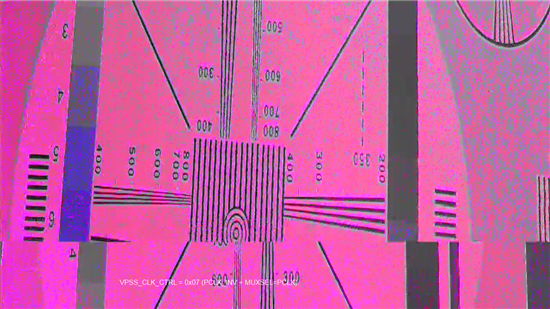

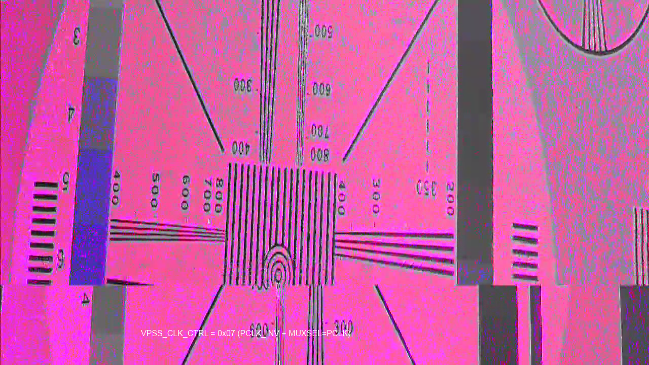

  • Following the experiment above, I decided VPSSCLKCTL wasn't being set correctly for PCLK input (I still can't see a sensible looking bit of code where it's all configured) but changing the above line to:
    gCSL_drvGpioObj.sysRegs->VPSS_CLK_CTRL |= 0x00000007;
    Resulted in this:
    So at least it made a visible difference this time!
  • Could you check with a scope to make sure you're running at the correct frequency?
